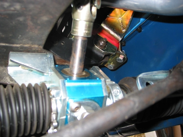

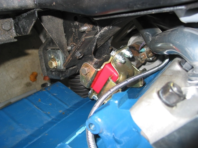

67s used a different frame mount than 66s or 68s, and vert mounts are different than coupe and fastback mounts. So having a 67 vert does make things tougher. I put the prothane solids in my 67 vert, I don't think they are as good as the TCP solids but they cost less than half as much.
They can be found just about anywhere speed-parts are carried, I got mine from Summit.
That linky no worky, but they are part number PTP-6-503.
I should probably mention that there's another thread here somewhere that folks said they don't fit on 67 frame mounts. Summit's site says they do, but they don't list hardtops and soft separately so YMMV. They did fit on mine as the pictures prove.
