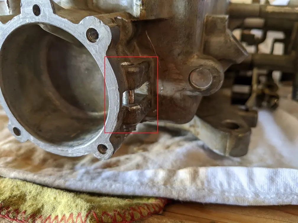

Hi, I'm replacing some parts on my Autolite 4100 on my 1966 GT Fastback. I need to replace the secondary lever, but having issues getting the pin out. I'm a newbie and I'm thinking I don't have the right tools. Any suggestions on how to get the pin out? [image below]
Can you drive the pin out with a punch? If it is setup so that it is open on the bottom then I would put something under it to support it and then using a punch try to tap it out. It shouldn't take a lot of force to move it. Then you can put the new arm on and drive the pin in from the top.
