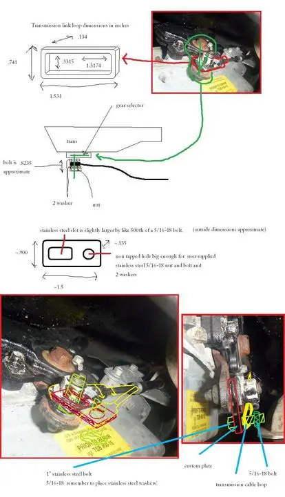

Yup this is how they are on all are cars at first. You have to bend the linkage that the cable connects to give it enough room to go into park.
yea, this is fun!
push the transmission all the way forward into the park position.
then push the hammer shifter all the way into the park position.
then hook up the cable.that way you can at least start the car in park. the cable is litterally 1mm too short. you may have to slam on the shifter to get it into park then the car starts!
also the brake linkage cable, your talking about that little silver line right? mine does the same issue, its hanging on to the shifter but its kinda loose. I was worried about that too. you can shift the car into any gear without your foot on the brake or keys in the ignition. I had a pro shop look at it, and they said it was ok.
OR you can have a machinist make you a part that will give you that extra bit of slack if you dont want to fight with it.
