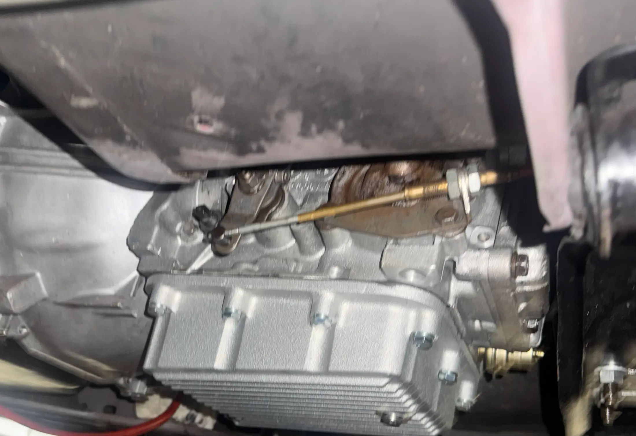

I’ve been having trouble getting my cable to line up correctly on my C4 with a B&M Hammer shifter. I’m using the C4 install kit, and I’ve already added spacers on the servo cover mount like some people recommend. That helped a little, but it still won’t fully lock into park.
If I adjust the linkage in 1st or neutral, it lines up in every gear except park. It seems like it’s just barely not pushing the arm far enough to fully engage park.
Has anyone run into this before or have any suggestions on how to fix it?

It’s a 26 spline c4 in a 90 mustang with a foxbody hammer shifter and the b&m c4 hammer shifter conversion kit on it
