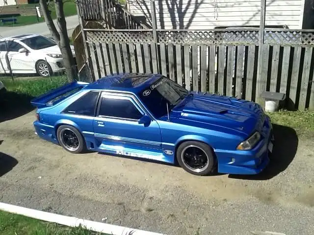

Hello stangnet.... new member here.. new to foxes too... i have a 1992 Lx , and i have a few questions about some stuff..
first question, will a bad or dieing fuel pressure regulator cause a car to surge or spudder while maintaining speed.. ive tested my fuel pressure and its showing 40 KOEO BUT one time i tested it and it only showed 10psi KOEO... and if i test with the vac line plugged into the fuel pressure reg its 28-30.. but with the vac line off and plugged its 43 all day long... and my fuel lines hold pressure for a long time.. so i kno its not a leaking or open injector.. also if i drive the car with the vac line plugged into the reg the car spudders while maintaining speed..and if i was to unplug the the regulator and plug it and then go for a drive the car does not spudder and has great power and drives normal.. and no theres no gas leaking from the top of the reg. Im thinking i might just buy a AFPR and set it at 38-40 and drive but not to sure about it.. so hopefully someone can help me out here before i either cause damage to my motor or do something i shouldnt... lol Thanks in advance and any advice is good advice in my books...
Btw The cars name is "Blucifer"
