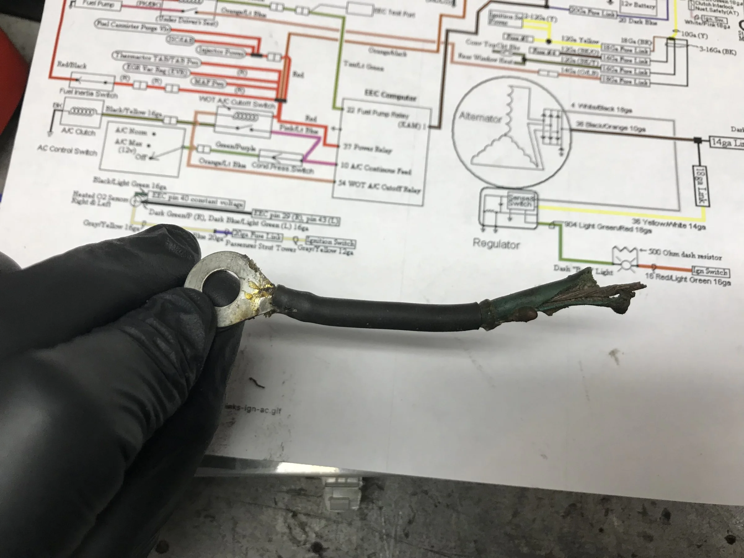

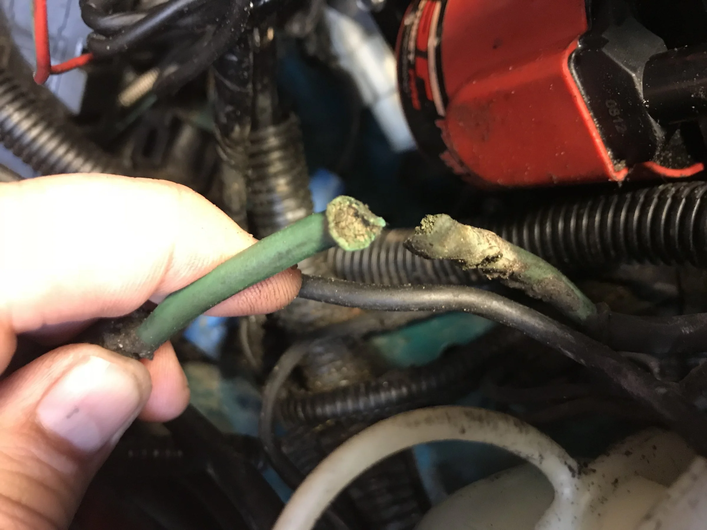

Now I’m fit to be tied. Sure enough, the green fusible link crumbled apart in my hands.
I replaced it with a new one, and I also replaced the alternator, because I didn't like the diode test readings I got, and because it failed the tests AND stalled the drives at two different testers at different stores. It was making a bad scraping noise inside. it, I'll put a new one in. It charges perfectly, it's connected properly including the stator wire, I've replaced that fusible link, but...the goddamned battery light is still on.
I decided that before I go any further, I better degrease everything. Now my house reeks LOL
