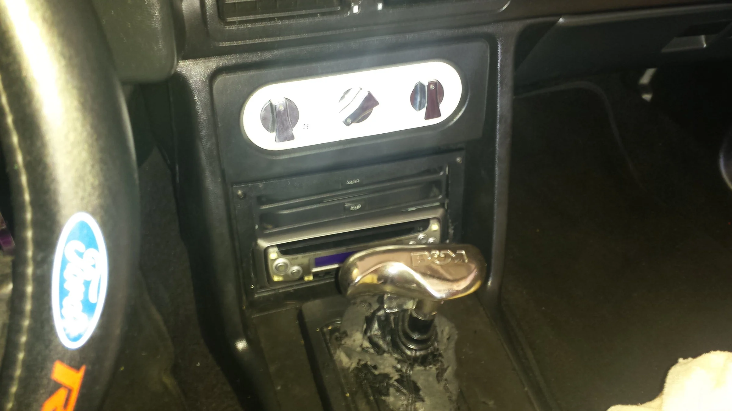

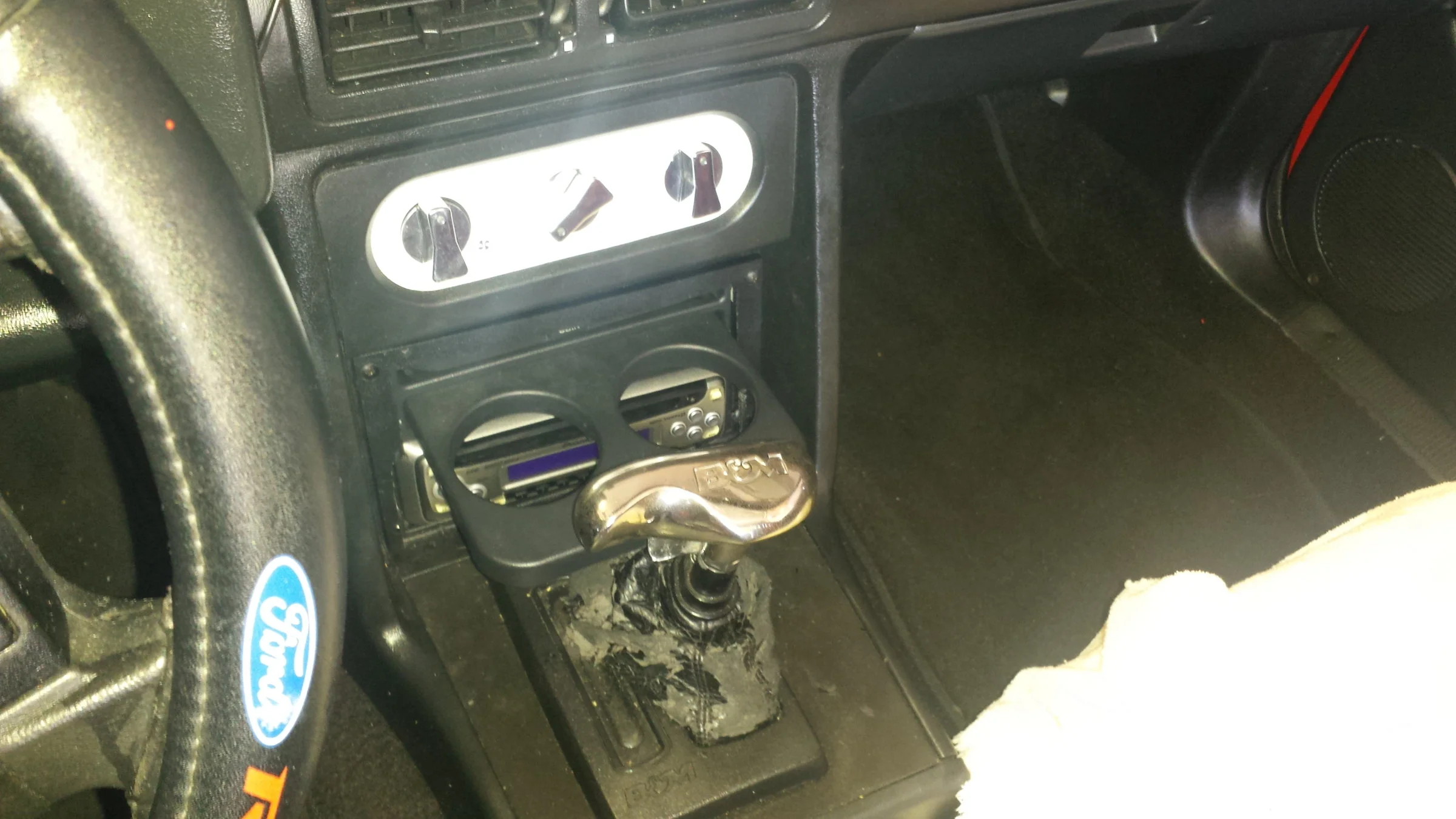

The age old question- why doesn't the fox body come with factory cupholders? While at the JY I saw an in dash slide out coin/cupholer in a Taurus that looked like it might work. After an hour or so of dremel work on the cupholder, clearancing the trans tunnel with a board and BFH, I had to move the radio down and trim about 2 inches off the back of the cup/coinholder with a dremel. Still have to work a little on the bezel, but I think it's pretty cool to have slide out cupholders now. Disregard the crappy old leather shifter boot. New one is on it's way.

Its a good 8 inches long and the sam width as the stock opening. I had to cut off a good 2 inches off the back of the cup holder to clear the airbag module under the dash. Sorry can't remember what year Taurus other than it was a mid 90's. You will need to massage the trans tunnel as it slopes up. I used a BFH with a 2X 6 and with a right angle cut off wheel on a dremel knocked off the heads of the bolts that hold the console bracket The cupholder is a perfect width for the opening but is too wide, so you have to provide clearance for it and the radio to fit. I also had to trim the plastic radio trim piece. It wont work with a stick. You need to move the radio down as the cupholder hits my B&M shifter plastic bezel and wont extend all the way if you install it in the lower slot position.
Ideally, if they still made the HVAC relocation panel I would have installed it in the existing HVAC location and moved the HVAC controls down.

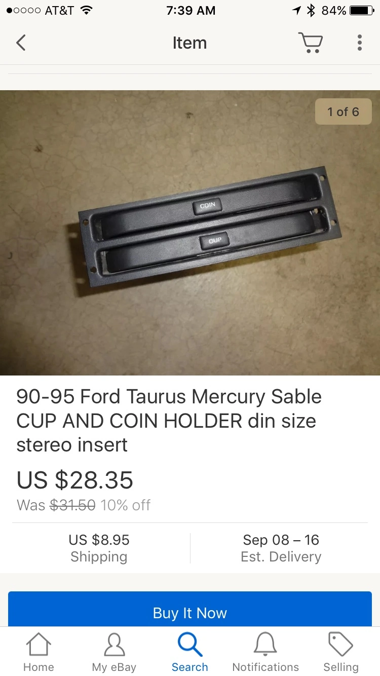

Here's the coin hokder. A lot of other vehicle owners have used these to add a cup holder to their car as well...that's why they are still $30 or so

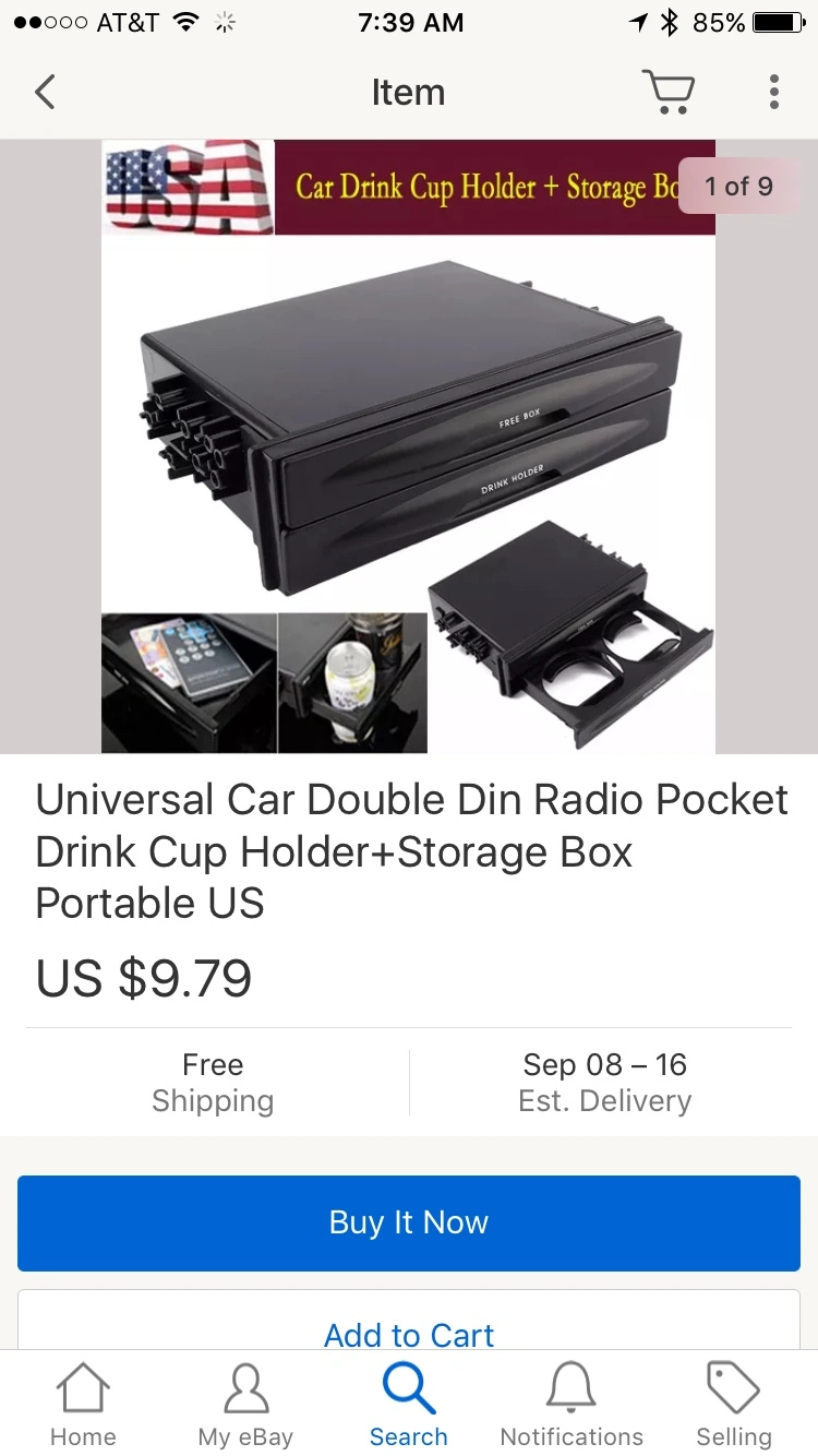

Aftermarket caught wind that there was a market, so there's this option too

i paid $4 at LKQ.- Mike.. I actually like that universal one

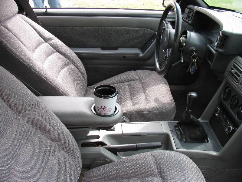

Does anyone make a cup holder in place of the armrest?

Yes.

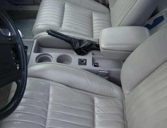

I know I have posted my solution here before, but I too got tired of wedging drinks between the handbrake and passenger seat.
