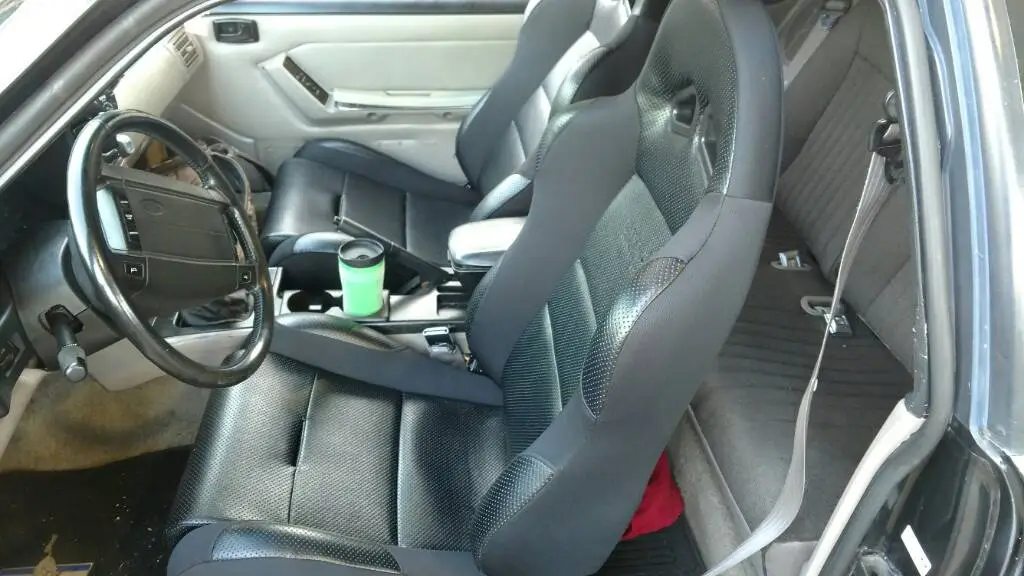

The age old question- why doesn't the fox body come with factory cupholders? While at the JY I saw an in dash slide out coin/cupholer in a Taurus that looked like it might work. After an hour or so of dremel work on the cupholder, clearancing the trans tunnel with a board and BFH, I had to move the radio down and trim about 2 inches off the back of the cup/coinholder with a dremel. Still have to work a little on the bezel, but I think it's pretty cool to have slide out cupholders now. Disregard the crappy old leather shifter boot. New one is on it's way.
That's pretty cool. I think it looks really good but I have to agree with @Mustang5L5. I don't think it will work well in cars with manual transmissions.

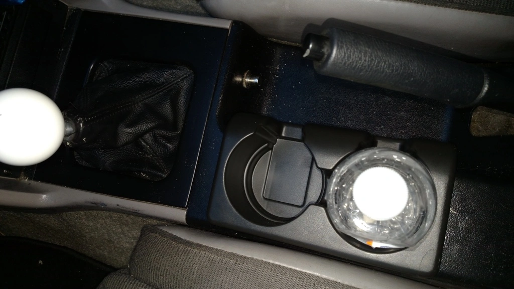

I know I have posted my solution here before, but I too got tired of wedging drinks between the handbrake and passenger seat.
This is the best solution in my opinion. I recall seeing your write up at some point. I'll have to look it up again.

please link me to a write up thread on how you created this or where you got it from. Thanks!
I did do a write up on here a few years back when I made it. I unfortunately do not know what vehicle the actual cup holders were in because it was a broken panel laying in a pile at the junkyard and I noticed they looked to be about the right size and depth. I basically just cut the ashtray section out and bought fiberglass cloth and 2 part fiberglass to secure it in place, sanded it down and used a little body filler to make it right. I also moved the lighter socket back so I could use it as a 12v plug for my cell phone or anything else. The only issue I had was deciding what to do with the grain pattern, I ended up sanding the entire console completely smooth and it does not bother me as it is but I did purchase Texture Coating from SEM Products and am going to play with it to see if I can come close to the factory texture one of these days.
