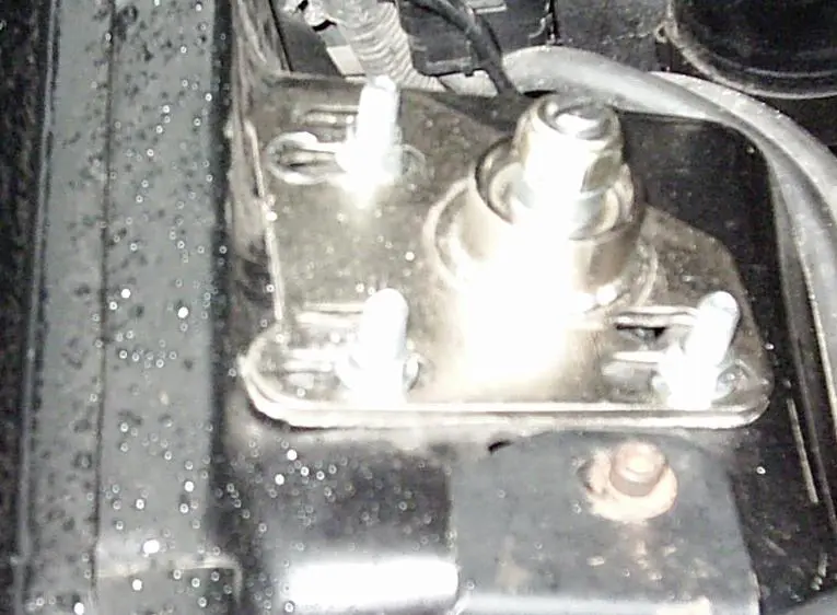

Here are some pics...

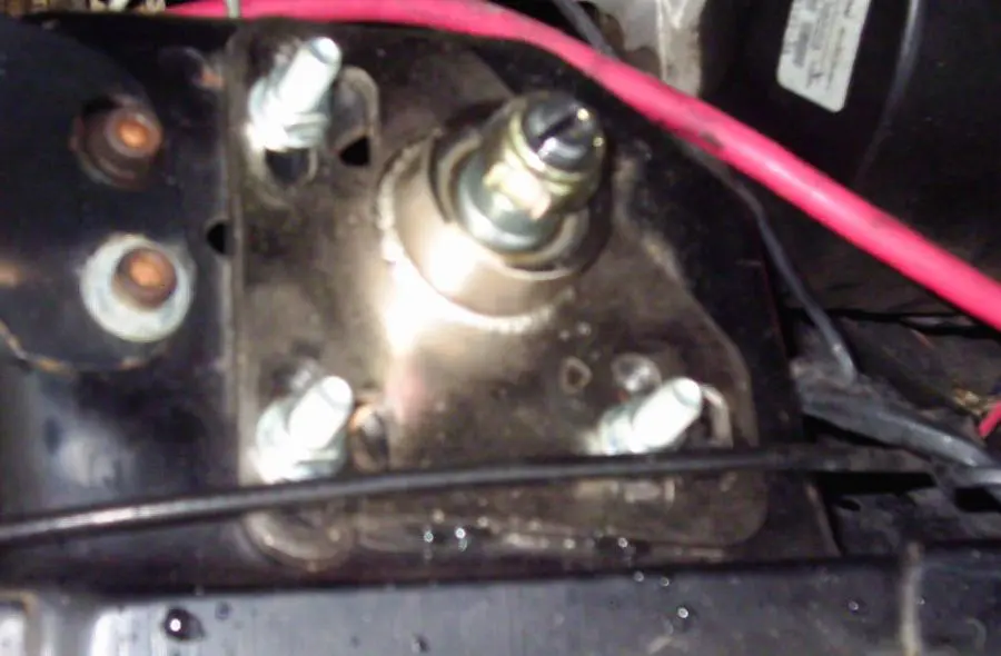

more...

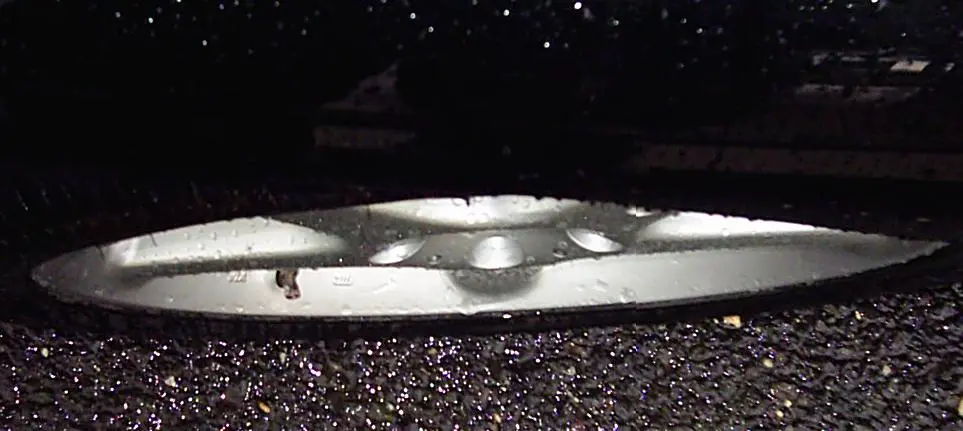

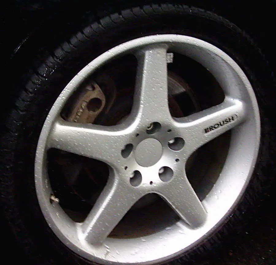

as you can clearly see, the wheel is not on the pavement straight (the top is in by about an inch +) and the plates are against the fender...

What do they consider "in the green"? Did they give you an actual reading. Anything around 0 to a negative 1 degree of camber if fine for daily street driving.

If you need to, take the CC plates off, grind the slots enough to allow for the necessary adjustments, reinstall and take it back to the shop.
If the CC plates are big enough to grind what you need off, take the plates to a machine shop and have them fab some bigger ones.

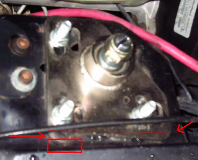

i was thinking that i could shave the edge of the plates so that they could go a little but farther out, but even if i get it set - that still doesn't address the problem with the car...
how could BBK springs, KYB shocks and Steeda C/C plates throw off the alignment this far? There has to be something wrong with the car...
the pic shows where i could shave the plate, the red box is where it hits the fender.

Well remember that anytime you lower a car signifcantly you start pushing the limits of correct alignment capability. That is why we need to use C&C plates.
I woudl say that the steeda's msut be strond enough to be able to trim what is needed. BUT before I beleive sears I would try another shop as I beleive you said you got your $$ back from it.
