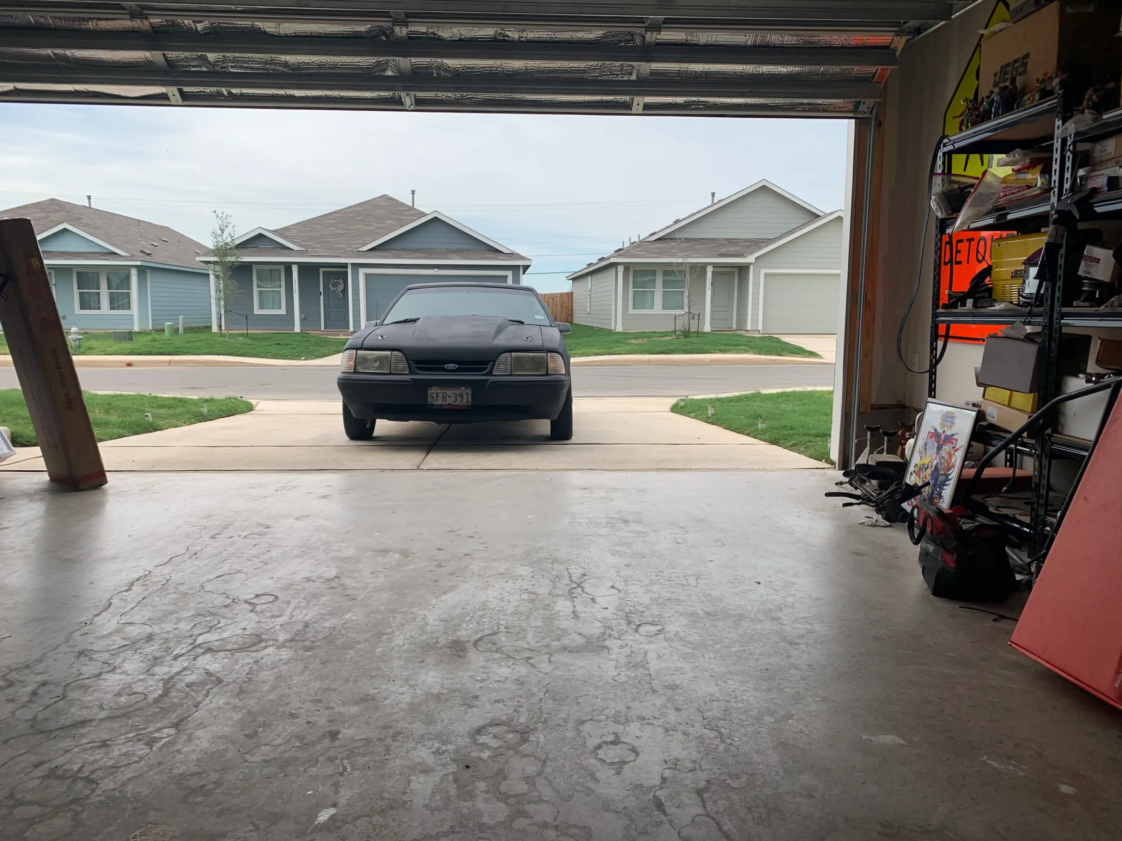

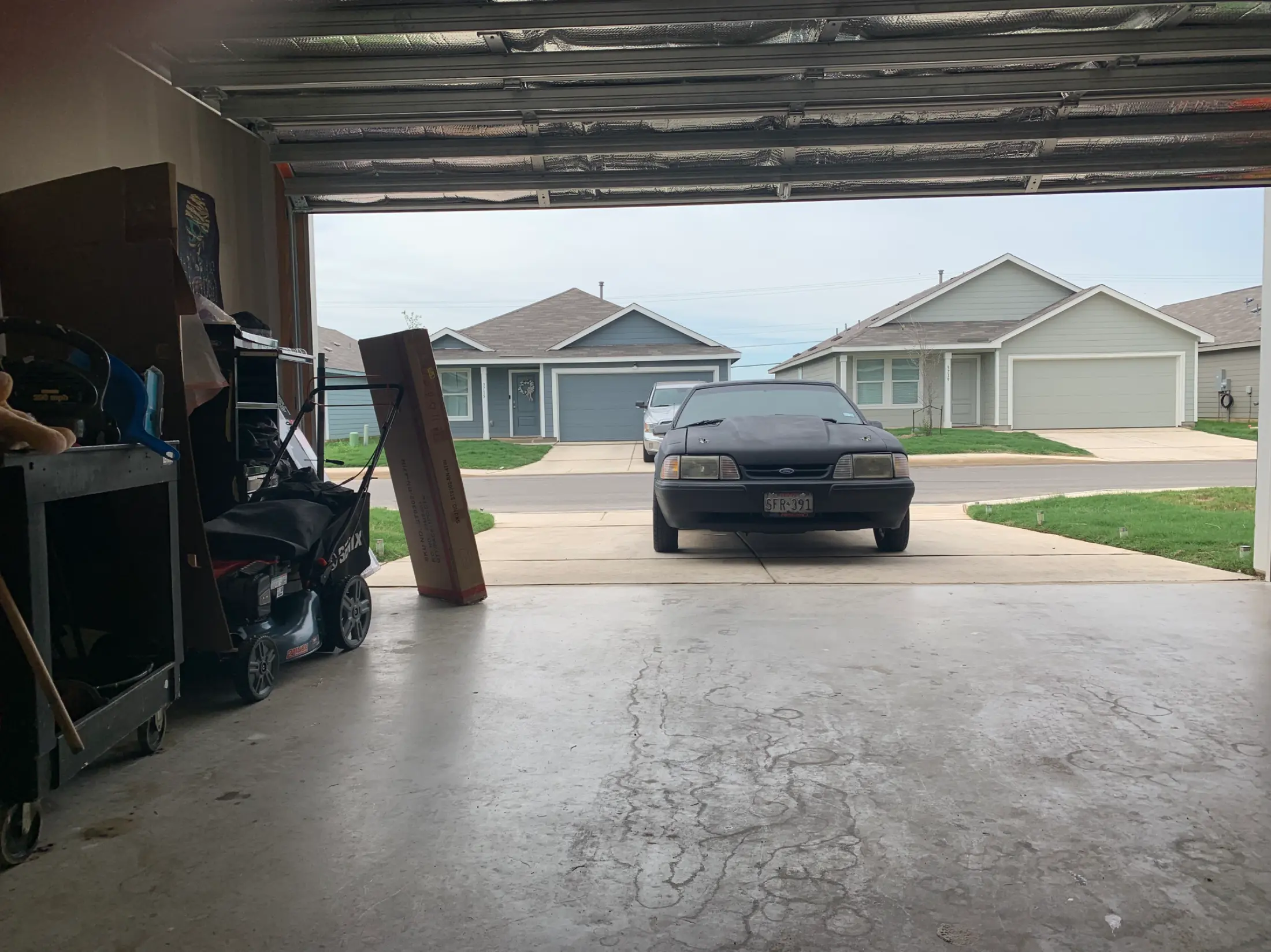

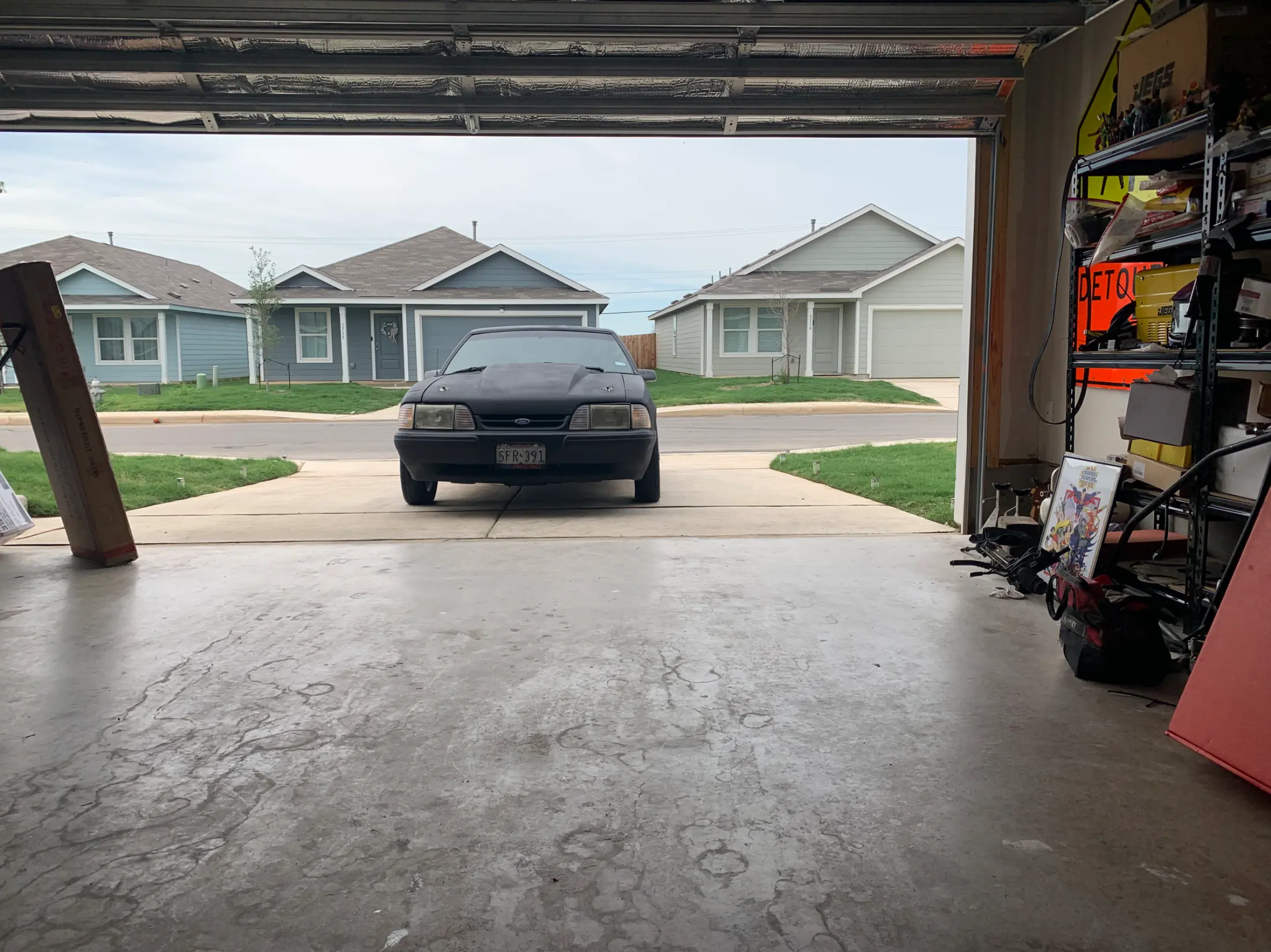

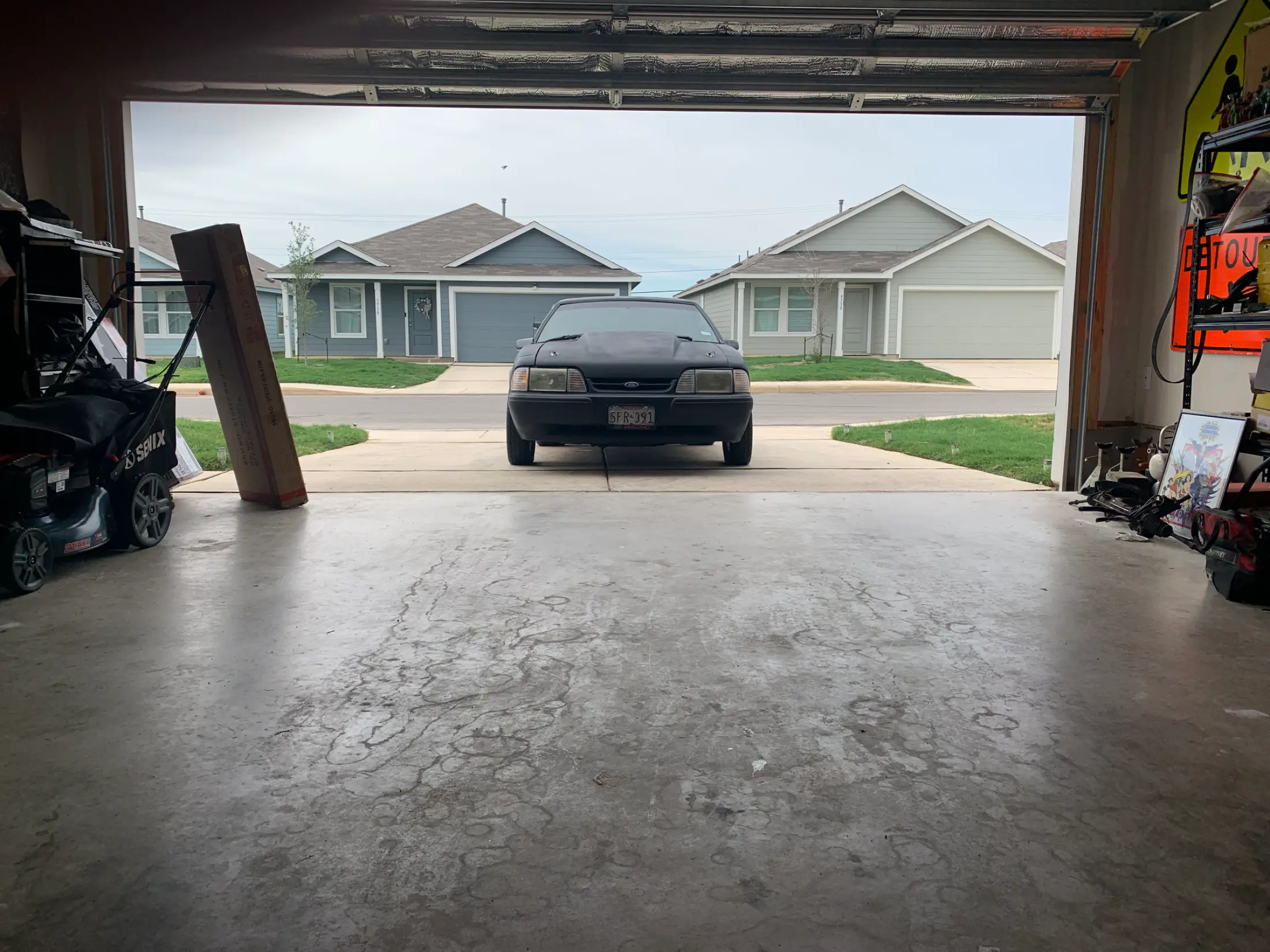

I lowered my mustang few years ago and did take it to have an alignment done problem is I don’t think they did it. It looks like an elephant sat on the car and my tires keep wearing out drastically in the inner part of the tires. Honestly I want to risk doing I w/o special tools (to purchase) was thinking of setting up a laser level on just measure bottom tire to light and top of tire to light to try and correct that tilt. So question is…… to do alignment myself to adjust it do I have to loosen the camber plate bolts or the tie rod ends(bumpsteer ends)? Do I have loose. Both the camber bolts the big ones and tie rod ends or one or the other ?

Let's play a game, 'how far off?'
Put car on level ground, make sure air pressures are same all way round, take one of those L shaped metal carpenter's tool and place the edge on the concrete, the other edge against the bottom of the tire, is the top of the tire (or tyre across the pond) tilted in?

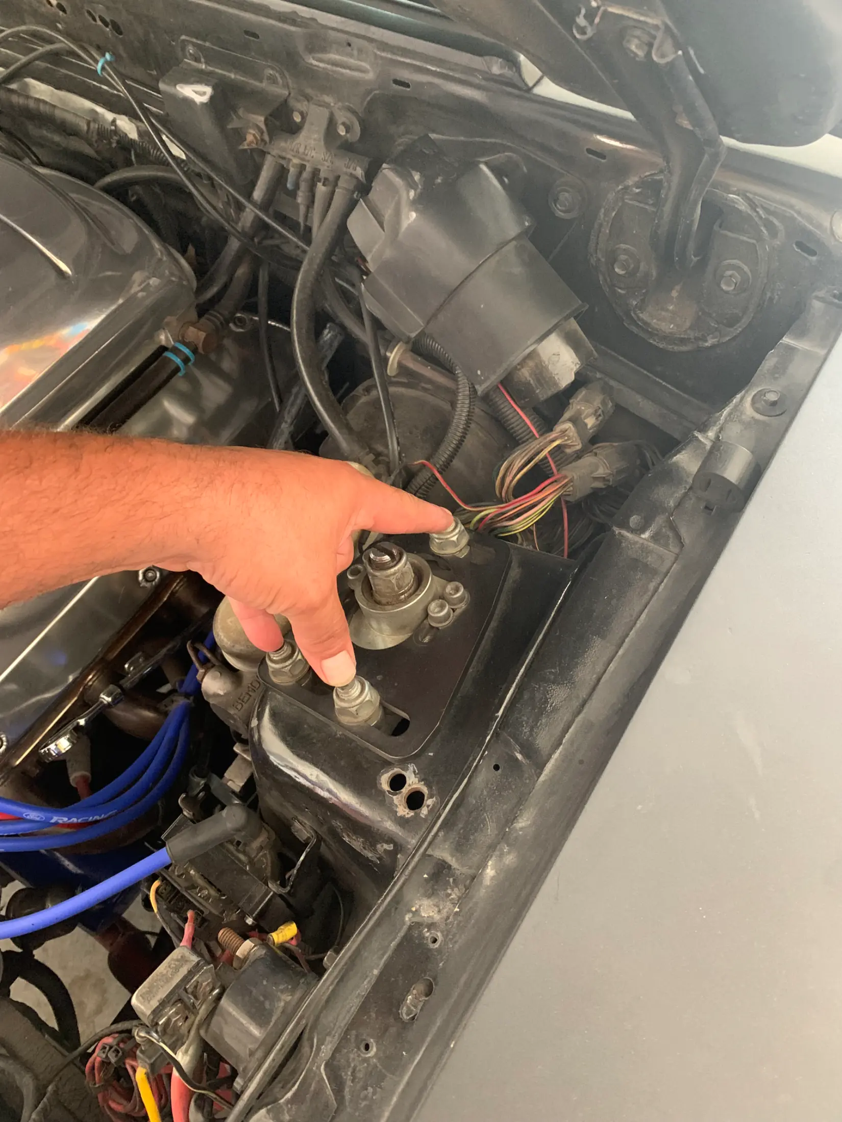

What I need to know is if I lift up car loosen up strut and loosen those 3 big bolts on the top of the camber plates would that strighten up the wheels. I have a negative camber how can I fix that. Just by moving those 3 bolts in the slot away from the car?
