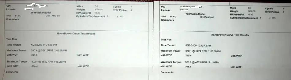

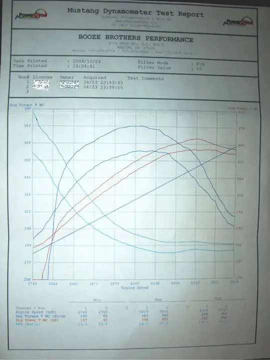

89stang1 said:
364rwhp 385rwt w/c....... the car made 382rwhp 402rwt 5400rpms before correction on a mustang dyno we all know dynojet would be more .......close enough?
whats ur combo?
and 364 is well off from 400
and i would love to see your graph.....from the numbers im guessing your running a smaller head and intake because you're tq numbers are alot higher then your hp.
89stang1
Stroked and Juiced
Nov 5, 2008
730
74
nj
Mar 7, 2011
#22
  • Mar 7, 2011
  • #22
gt40_2003wes said:
whats ur combo?
yup intake is a cobra... heads are afr 185s

i bet it's a blast on the street and really good numbers through a cobra.
