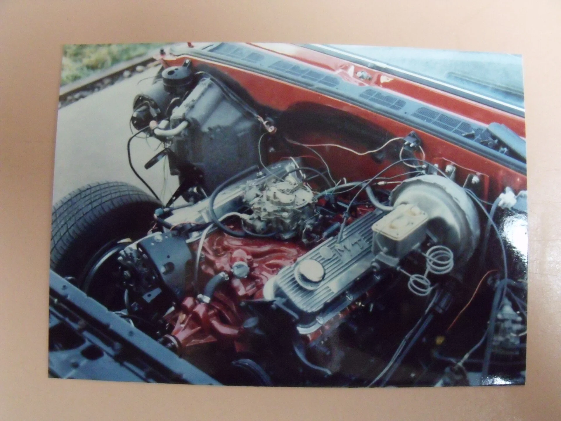

Can't remember if this 454 had any problems?
