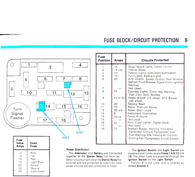

Hello, I have a 86 Mustang and the blower for the defroster was working just find.. Now after I changed out the battery , cables and starter solenoid does not work.. I dont know if I bumped something loose.. I have a Haynes service manual , but it is vey vague.. I dont even know what fuse to look for... If I have to will go get a ohms meter... Any help would be great...

Start by checking the fuses...

Fuse box layout

Thanks for the advice... I checked the fuses and they look alright
