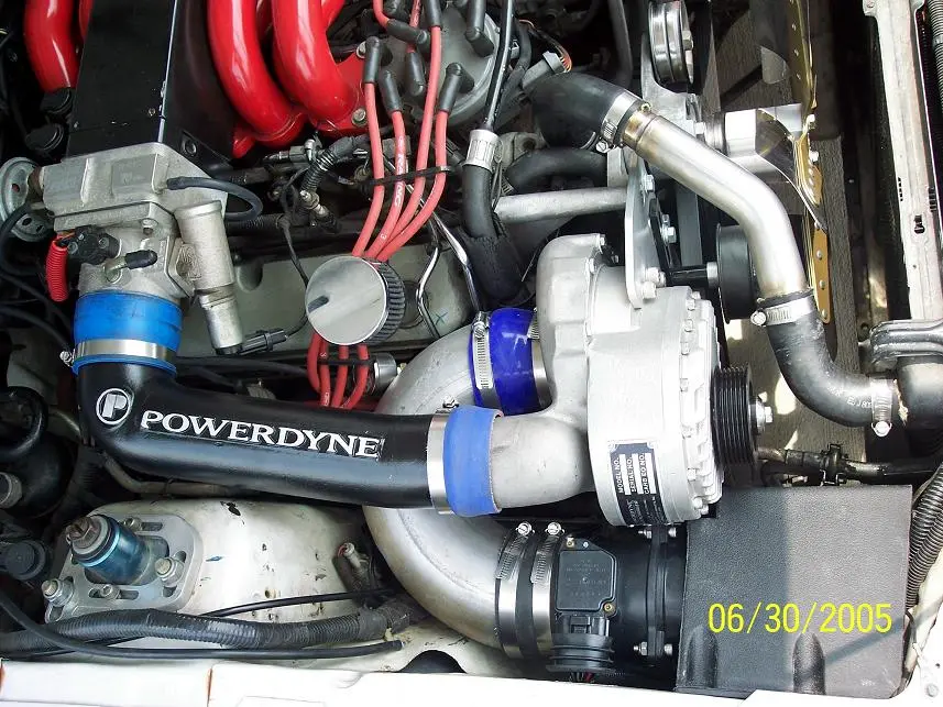

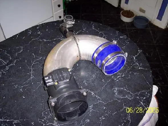

With the 4" inch powerpipe I made and 90mm MAF, I was getting 8lbs of boost at 5600rpms with a 6psi pulley on my powerdyne. I picked up almost a full sec in the 1/4 with just the 6 psi kit. im now putting a 9psi pulley on and should see 11-12 lbs of boost.

While I absolutely agree that the vortech and paxton will be able to make more total boost with the entry level heads, and I know of no powerdynes making 14+ lbs of boost , no centrifical charger brings the boost on earlier in the rpm range than a powerdyne.
