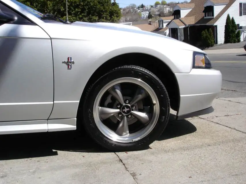

My '03, while never being hit, does have some interesting gap differences.
Nothing the average person would ever notice, but when you hand wash your car twice a week, you tend to notice every line on it.
Just look at Ford's lovely door/fender alignment :nonono:
HOLY CRAP!!! i just thought the body man was blowing smoke up my butt. But it seems that its a common problem. You would think ford would take pride in their automobiles. mustang5l5- thats a little worse then mine. But that is exactly what im talking about. and you cant really loosen the door cause its frameless. If you bring the door down to much you will get wind noises. I guess we are just stuck with the alignment issues.
