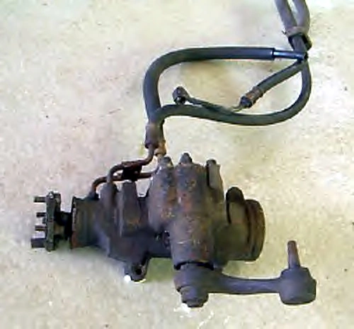

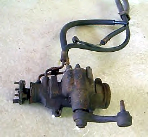

These look like the GM boxes to me. Is it possible to fit a used one from a GM vehicle and just get the hoses and steering column? And a pump bracket as well.
If you were thinking of the 71-73 Mustang steering…
