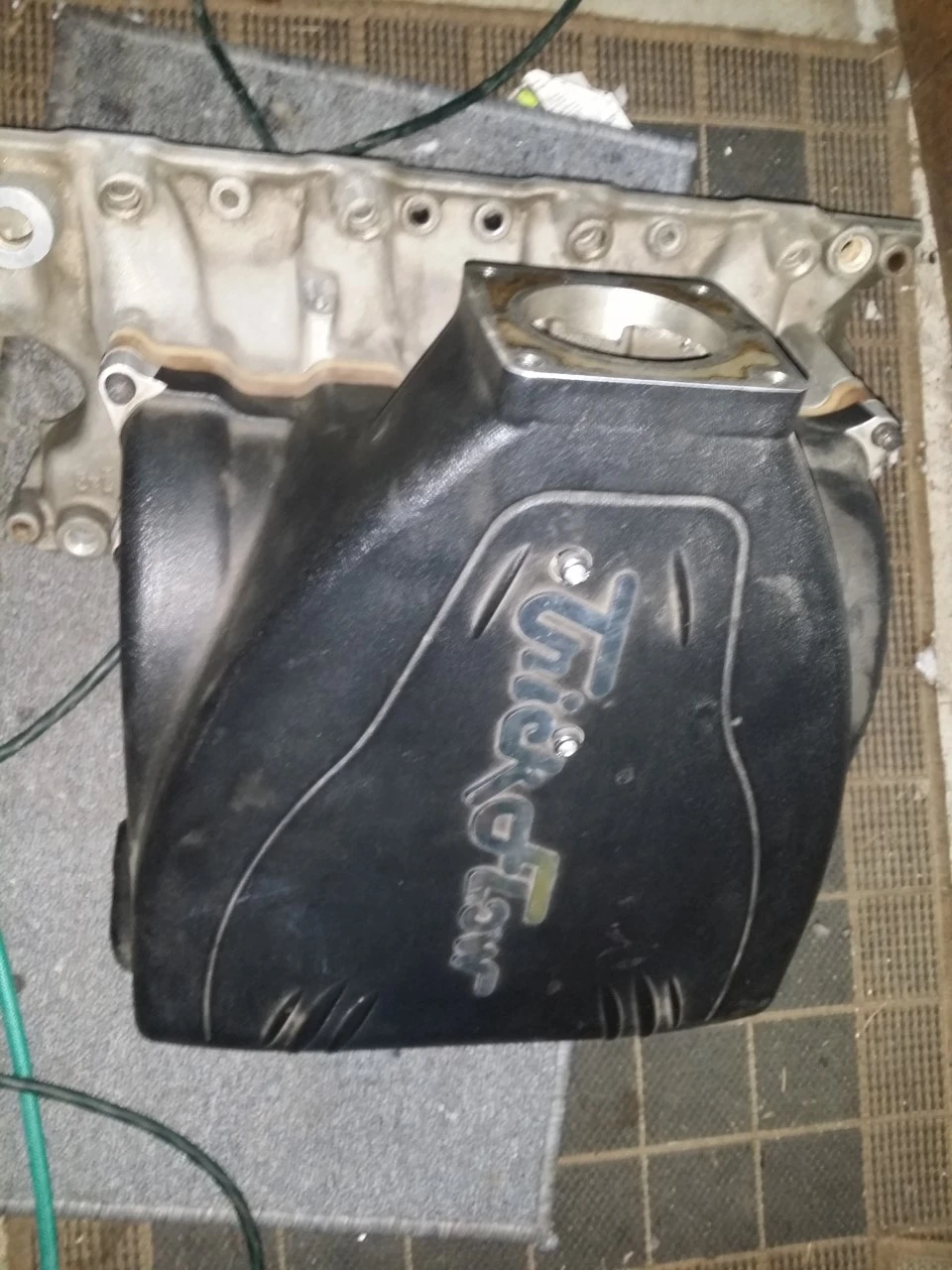

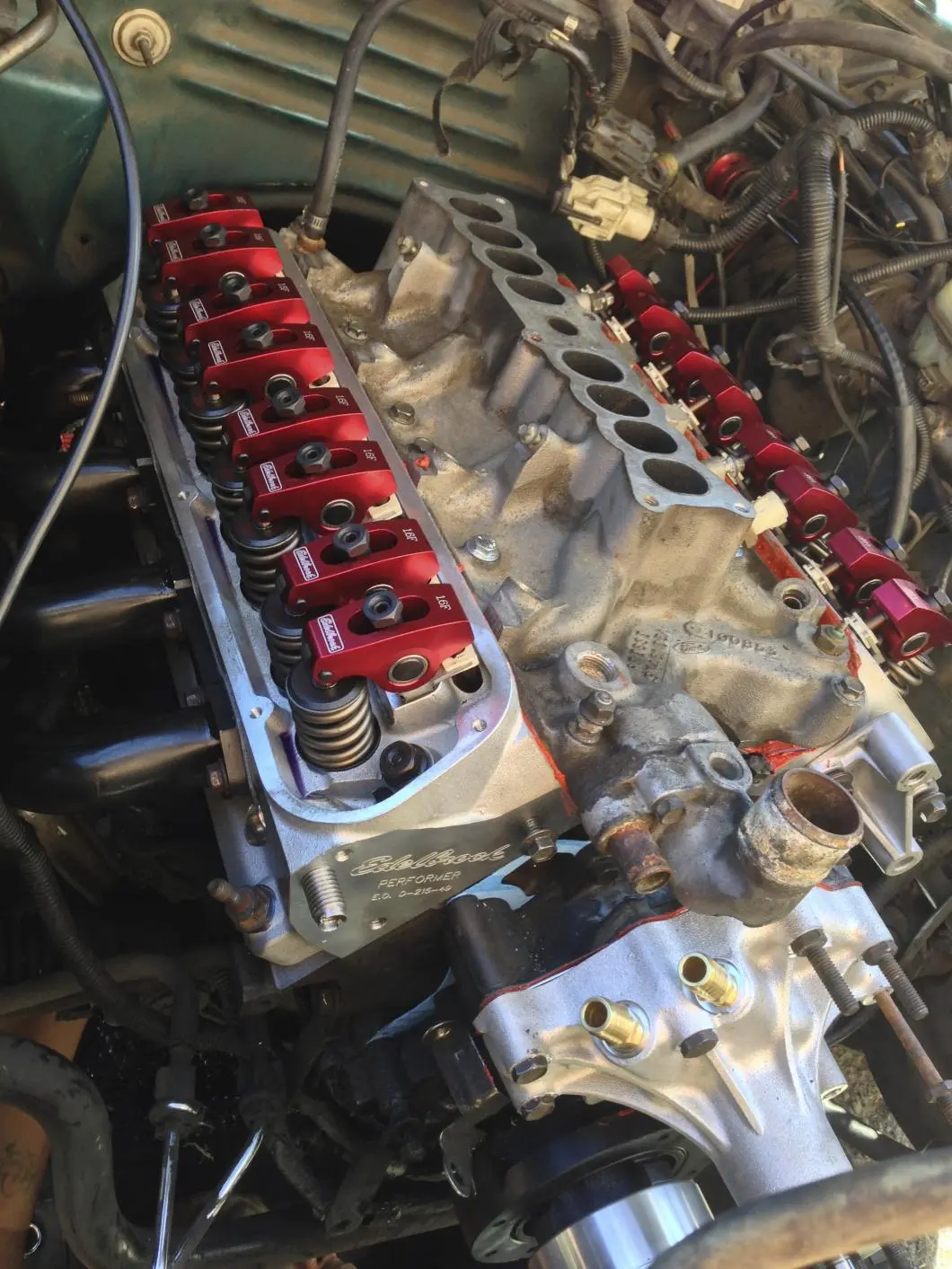

Hello guys , i recently bought a notchback black on black ( after 2 years of looking for a clean one ) and i need some help . First it's supposed to have some edelbrock aluminum heads how can i see if its true ? And when i bought the car he sold me an intake manifold trickflow (not installed ) ... Now i want to install it but i have no idea which intake manifold gasket to get can anyone help me ? The car have a couple of mods how many hp you guys think i have here the list : motor have been rebuild

It should say "Edelbrock" etched into the end of the cylinder heads, might have to clean it a bit if there's oil and grime covering it.
As for the gaskets, I'd call Trick Flow and ask them to send you the right bits. And unfortunately, I think that list of modifications is too incomplete to make any sort of estimation of power. So if I had to guess... somewhere between 225 and slightly more than 225.

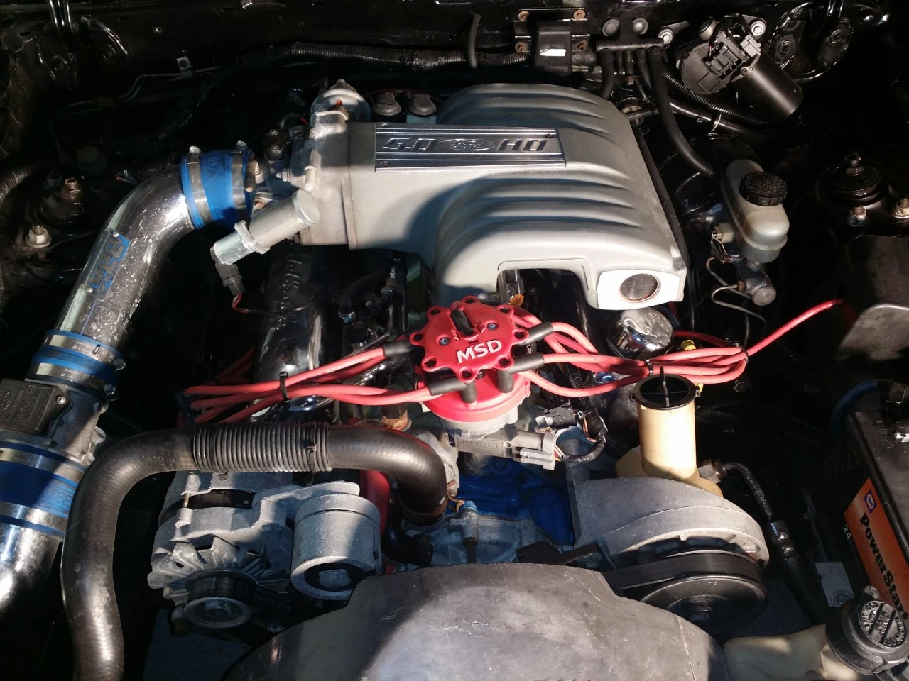

Post pictures of what your working with and maybe we can spot some other stuff the previous owner didn't mention

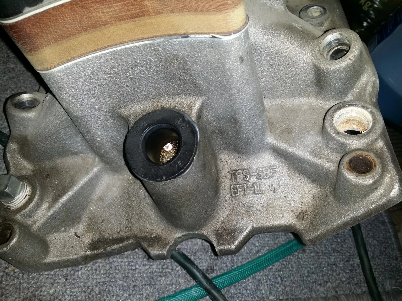

Here the intake

I spy with my little eye, stock 19# injectors! Maybe this guy didn't finish his engine build? I'm curious what fuel pump you have, maybe the stock 88lph? You'll need to verify. You're fine for now with the stock intake being a big bottle neck but when you get around to installing the intake you'll want to add 24# injectors, MAF calibrated for the new injectors, and 190lph or 255lph fuel pump.
Reactions: Foxbody 5.0

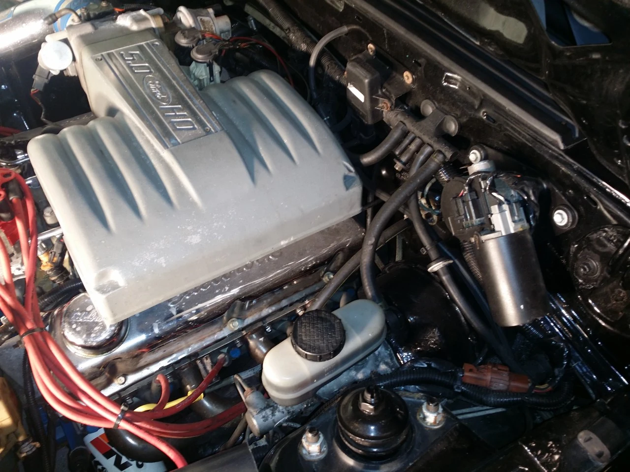

One more thing, you may or may not need that intake spacer. Make sure you test fit everything. You're looking for clearance for your throttle linkage (needs to clear valve covers) and if you use the spacer you may have clearance issues with your hood. While your installing your intake, please reconnect the EGR coolant lines and make it functional again. Deleting or disabling the EGR does not increase HP in any way.

Very nice car! Looks like the hood will clear easily A couple things I forgot to add is that I would change out the stock throttle body for one that matches the inlet diameter on your Trick Flow intake (75mm I think). What ever size throttle body you end up with you'll want to size your MAF just a little bigger (70mm TB/75mm MAF or 75mm TB/80mm MAF). Typically 24# injectors have blue tops while your 19# injectors will normally be orange.

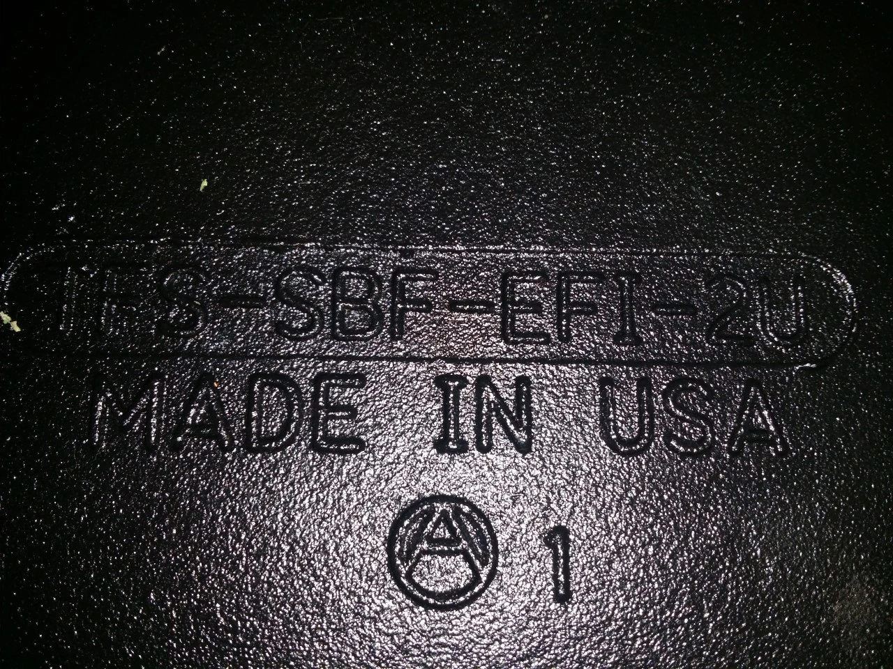

Are those carbed valve covers?
billison
I like tinted tail
Feb 27, 2006
2,607
1,094
184
stl
Jan 4, 2018
#15
  • Jan 4, 2018
  • #15
Yup! Efi has the fill cap and vac line on the passenger side. Lots of guys swap for a filter
