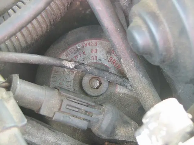

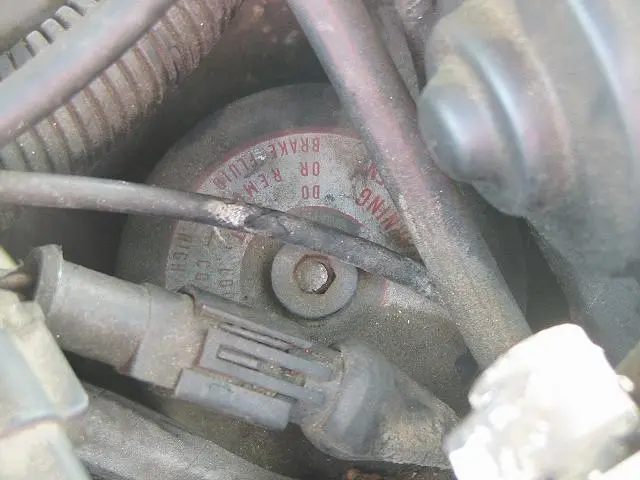

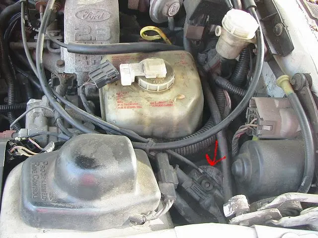

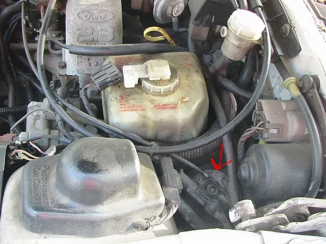

that pump keeps staying on on my car.. even when key is off.. what is it.. and how do i replace it.. ? anyone know.. or had this problem before?..
its drawing on my battery bad too so i had to disconnect it.. but brakes still work fine...

Actually what your arrow is pointing at is the pressure tank for the brake system...I would say the pump that pressurizes the brakes is probably what keeps running but I don't know. I'm honestly not sure what you would need to replace, you might try replacing the relay on the firewall (the one with the brown bottom, sticking out from under the plastic shield thing, right above the master cylinder...relay costs about $15 at the parts store). There's a writeup in the faq's section on www.turbotbird.com about diagnosing problems with the ABS system.
The pump or something just plain quit working on mine and I converted over to vac-assisted brakes:shrug: It's expensive to fix that stuff.
The round cylinder is the ABS accumulator. That's not the problem. The relay is sticking closed so power is continueing to flow to your booster pump. That's what your hearing. Here's the relay diagnosis from NATO.........................................................

The relay is located under this plastic cover (white arrow). I think it's the first one. Also check for a short in the wiring.
