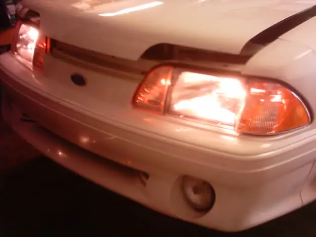

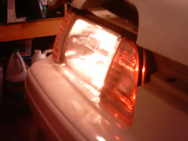

Now my car is at the shop and I attempted to take a pic to compare the bulbs output. When the pic was taken it wasn't near dark enough, motor was not running, and I couldn't back up far enough to get a better pic of the light color and output. Nor could I get a pic of the light as it cast on the shop wall. In person you get a much better representation of the difference.
IT'S NOT HID BUT IT'S VERY NICE!! I will try and take better pics when I get my car back and it's darker out
Here are the two pics: Silverstar (left) and MTEC 4X 80/100 (right)
Na you can see the difference if you compare the picts. Look at the lense illumination. And its probably greater difference in real time.

They don't compare? Judging by the pics you posted, my silverstars look brighter.
Loco5.0 said:
I didn't upgrade the harness in any of my cars when I put Silverstars in & the difference is night & day between the regular bulbs & my silverstars. No harness upgrade is needed to run Silverstars.
An upgraded harness is not needed to run the Silverstars or stock bulbs but it will improve the output and whiteness of the light if you do so.
You are making a judgement that your Silverstar's look brighter because you are viewing them in person and not through a pic.
The pics above show a Silverstar on the left (same as what you are using) and high watt on right. Judging from this there is no comparison

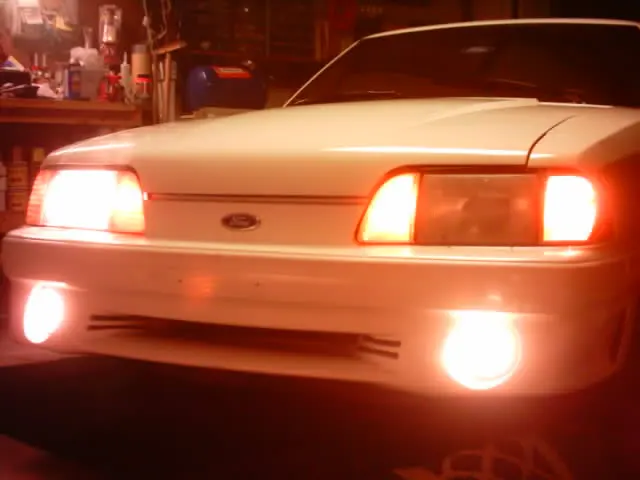

I like silverstars, but i do believe you when you say the higherwatts are whiter. Plus silverstars are like 40 bucks! heres some pics of mine, i have a stock, and then new headlights and silverstar bulbs
before
after
