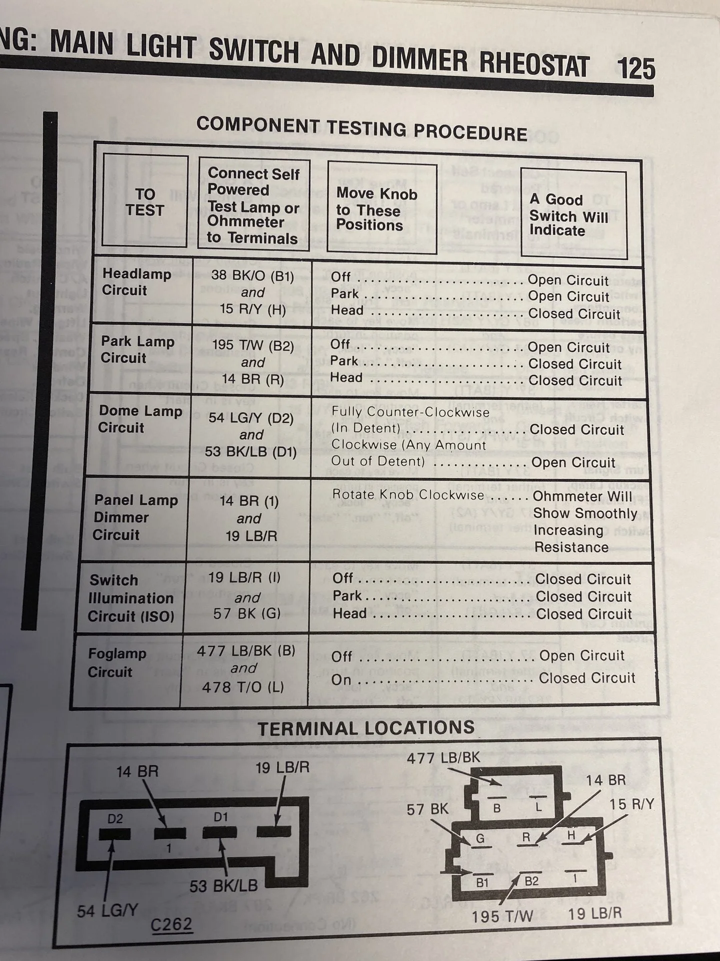

Here’s the wiring pinout for the headlight/fog light switch and the dimmer

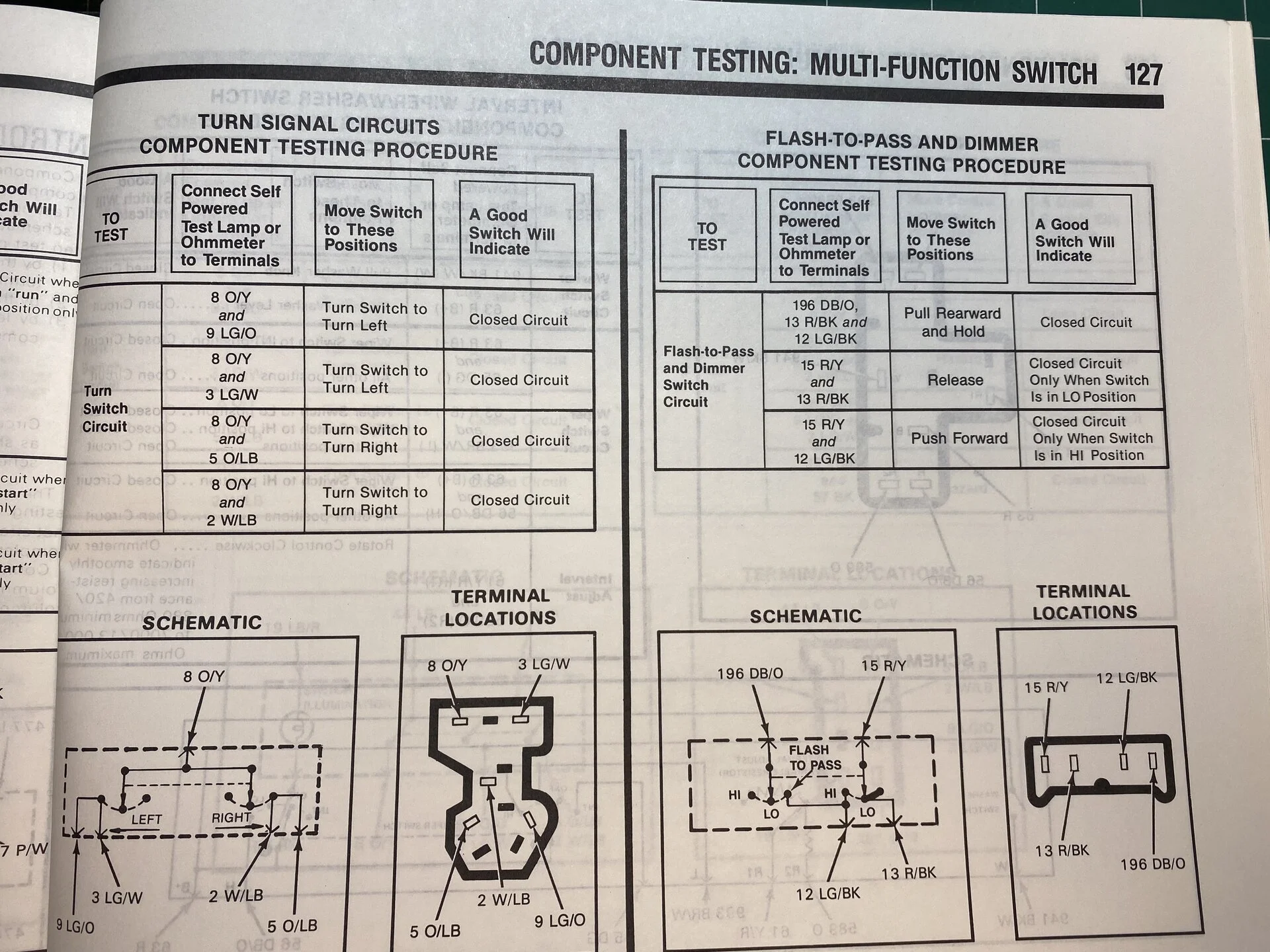

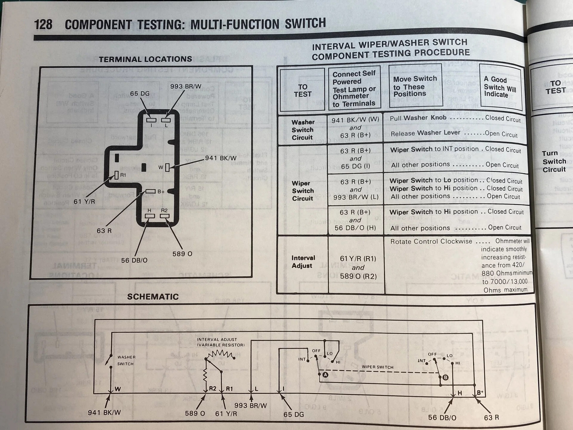

And here’s the multifunction switch
Reactions: General karthief and nards444
