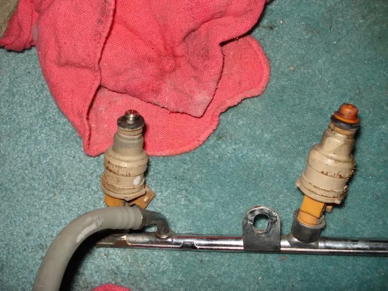

As I was swapping my heads and intake this weekend I noticed one of the orange ends of one of the injectors had broken off. I found the piece cracked in half in the injector hole. Do I need a new injector? Or will it be fine? Here's a pic:
That's just the pintle cap. The pintle caps hold the O ring in place and keep it from sliding off and into the manifold. If the correct pintle caps are used, they do not have any effect on the injector spray pattern.

Use motor oil on the O rings when you re-assemble them & everything will slide into place. The gasoline will wash away any excess oil that gets in the wrong places and it will burn up in the combustion chamber.
The pintle caps fit either injectors with a pin sticking out the injector end or 4 with more tiny holes in the injector end
Place the new pintle caps in some boiling water prior to trying to install them. It makes them soften up and easier to install.
