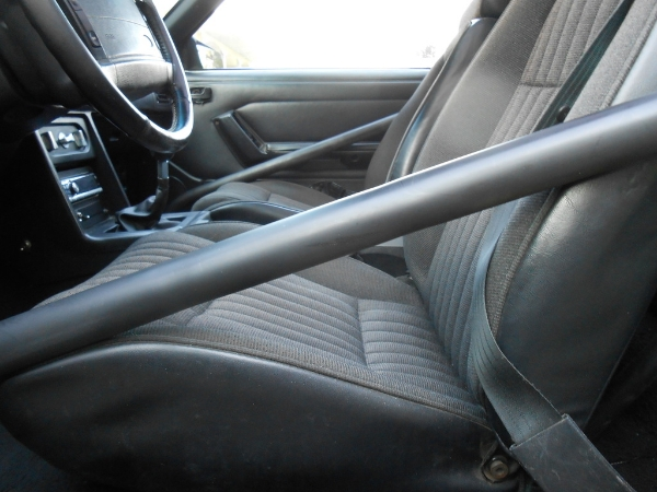

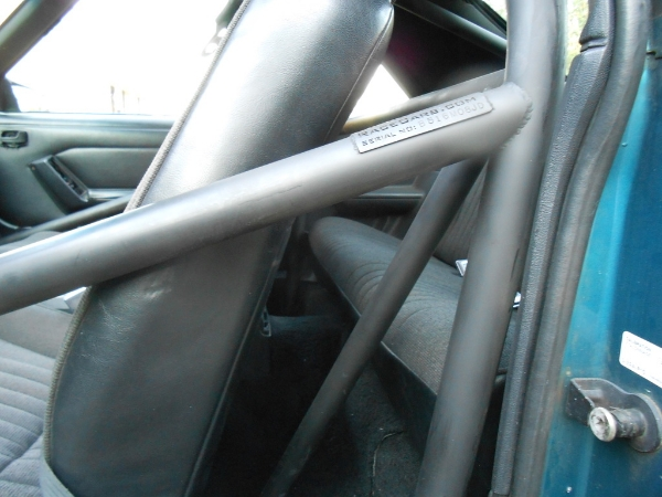

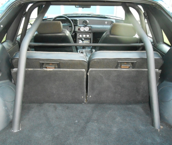

C/m Roll Bar

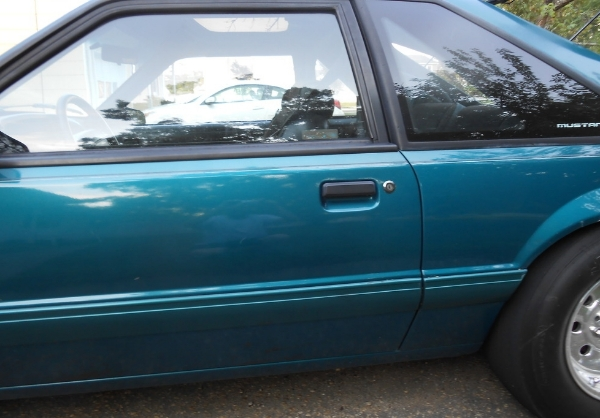

Thanks. I like the color as well...it has seen better days.
