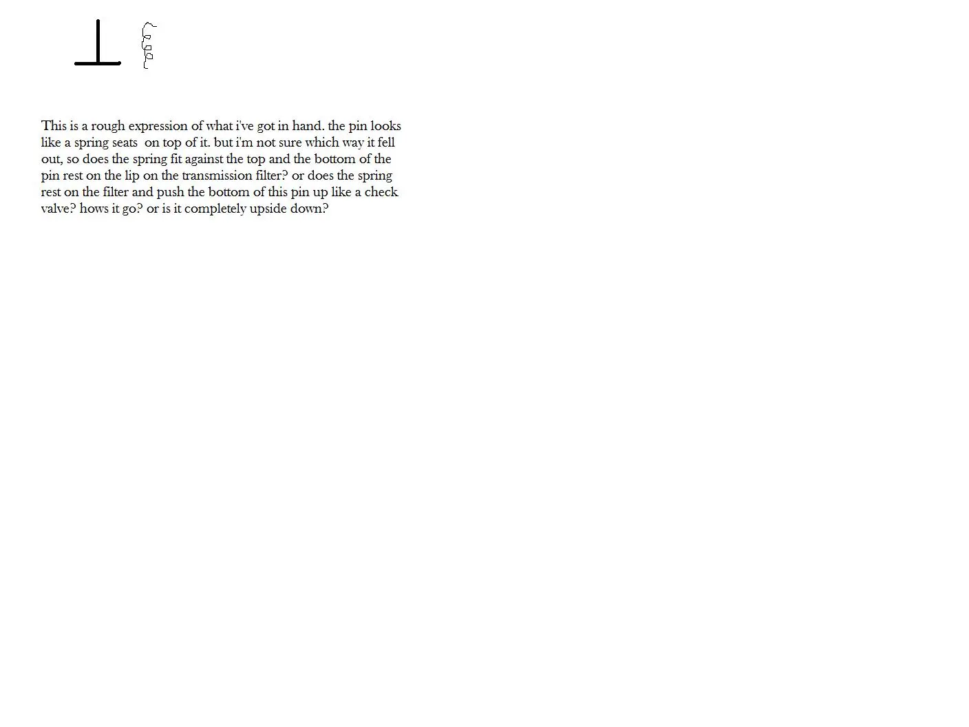

so just to make sure, this pin and spring go into the valvebody right where the notch on the filter into the valve body right? so what direction do they go in.. the pin is an upside down T shape and the spring is like one in an inkpen... so does the pin go in upside down with the spring up top or down below and on the pin? maybe a diagram would help rather than a description ha.. i'm not brain dead. just wanna get it right
