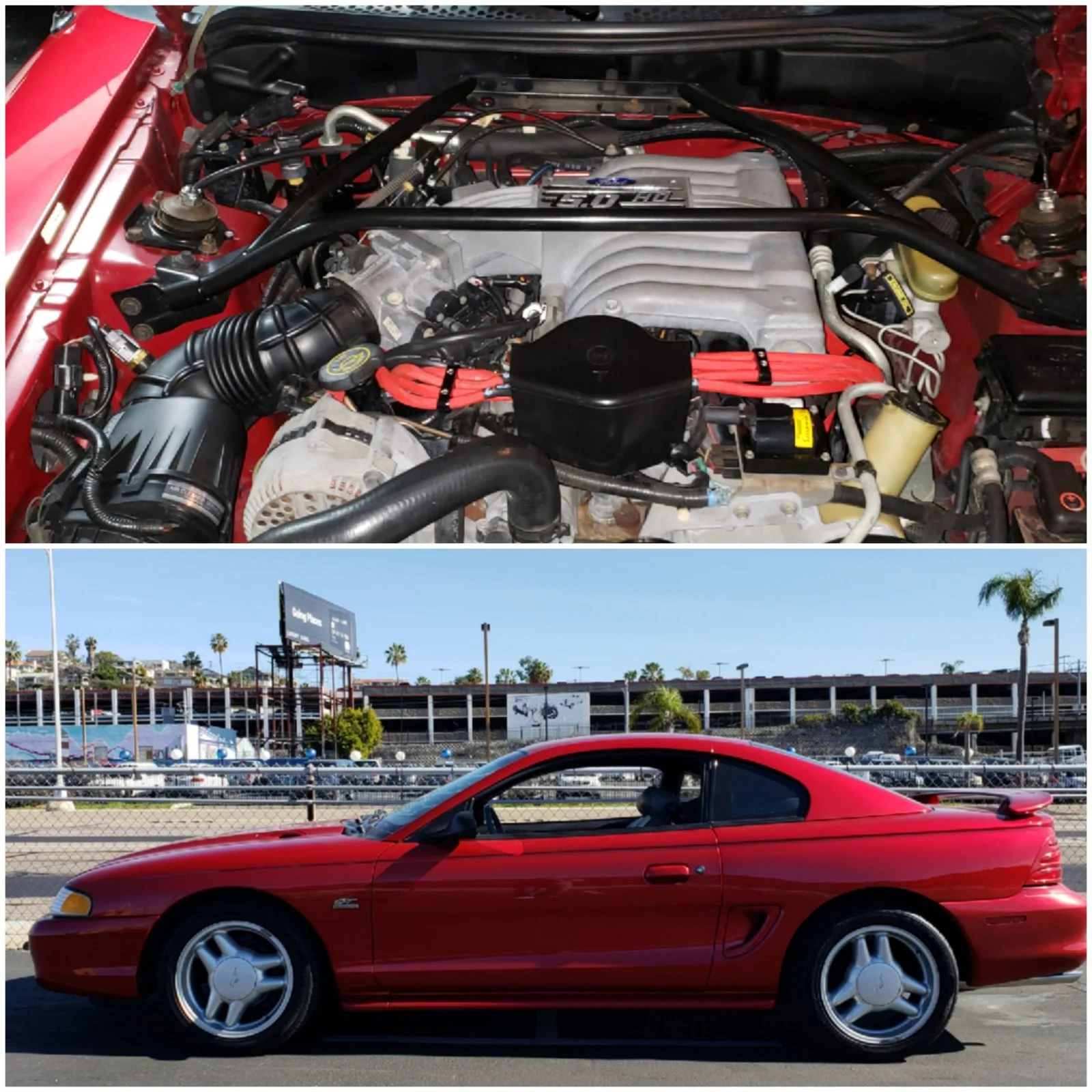

Will a CAI really make a difference on my 94GT I already have a K&N filter.

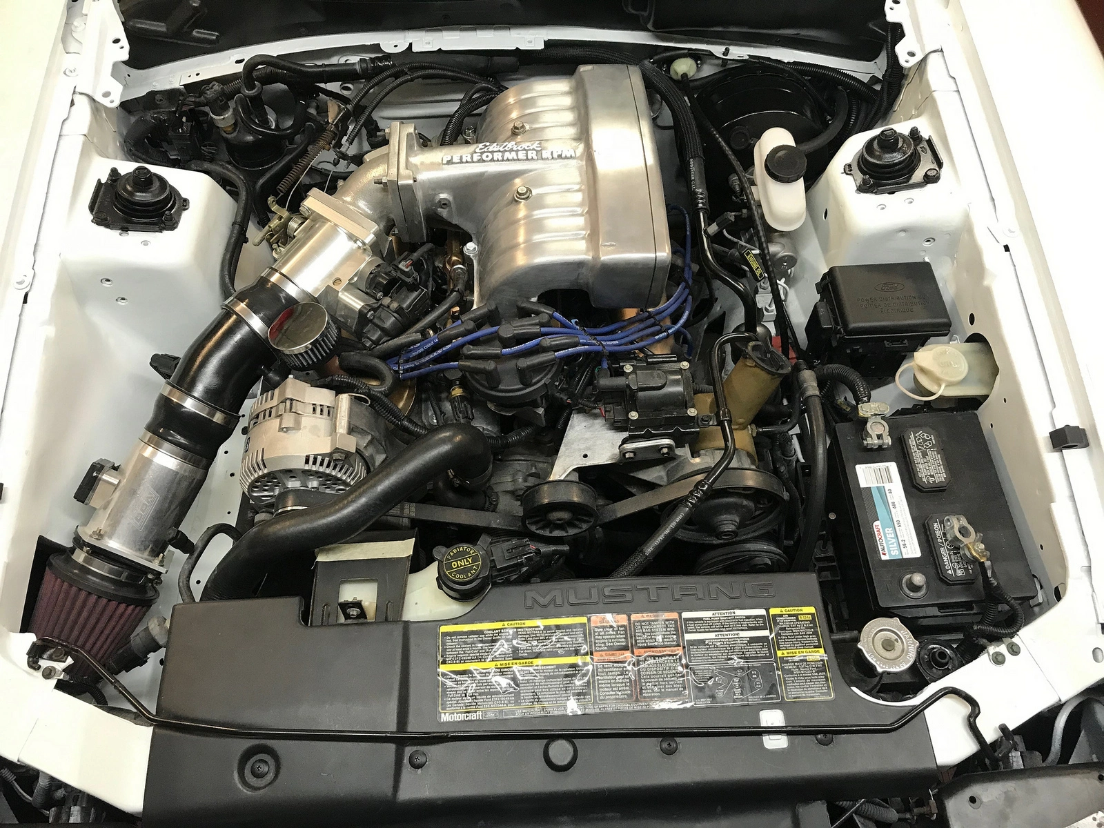

They do not. The stock one is 70MM with a 4-bolt flange and the next size up is the one in my After picture above. It's a 76MM BBK with 4-bolt flange. They used to have a Pro-M Bullet 75MM MAF with 4-bolt flange that I remember back in the day but it still didn't work with a stock air box.

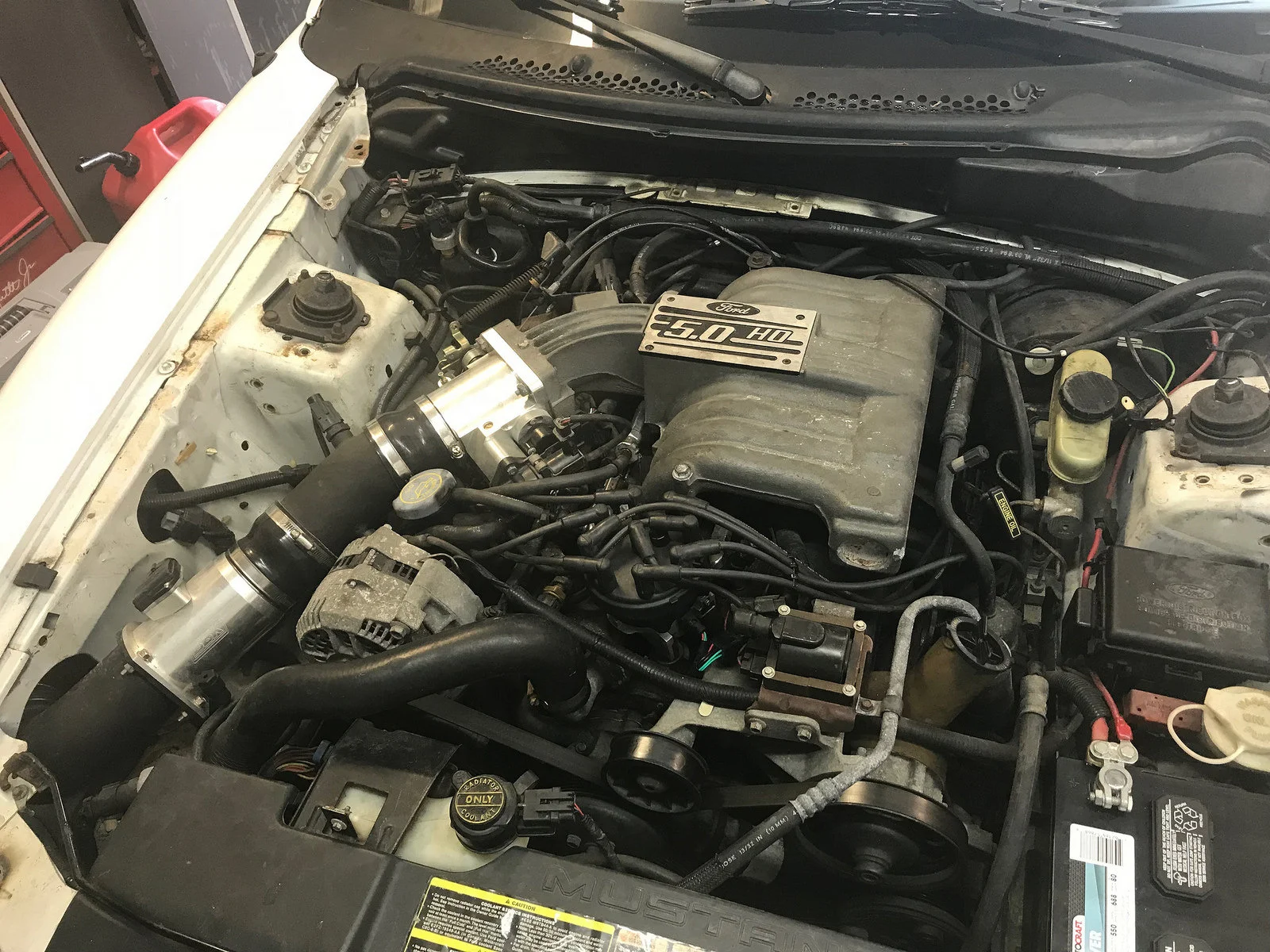

After market cai's wont get you any noticeable power. I made my own cai which has straighter piping than the aftermarkets provided. The only difference i noticed was the suction of air when tapping on the throttle.
