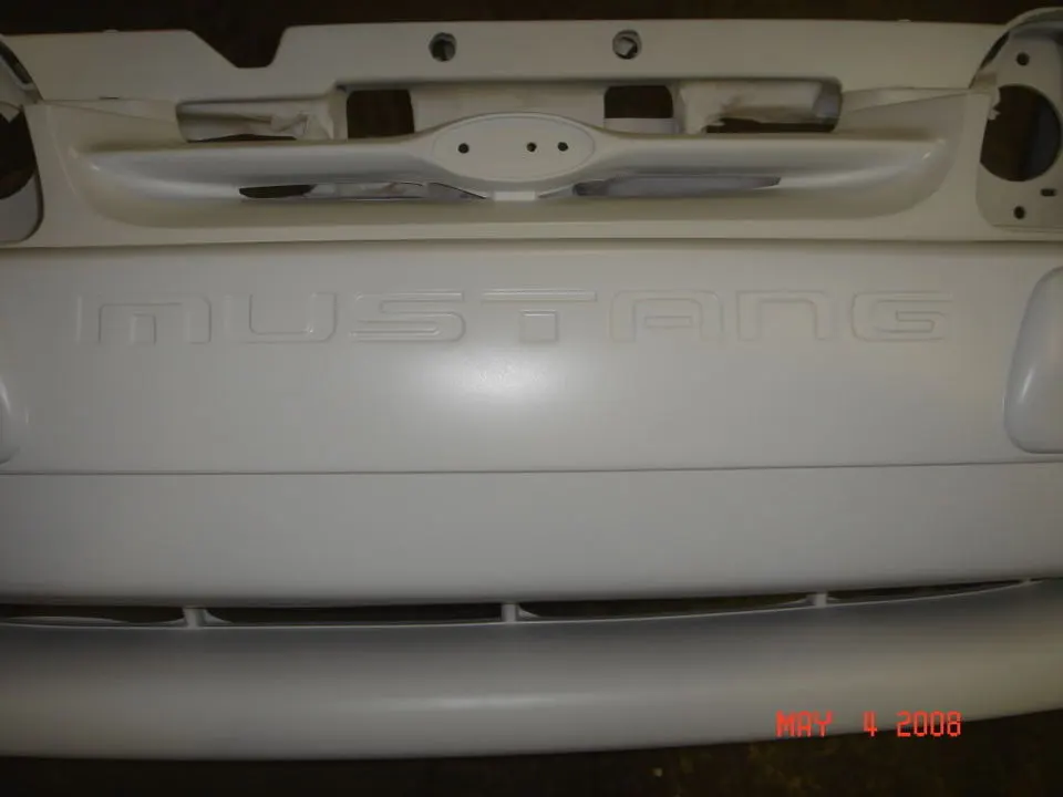

i dont know how permanent this would be, but i had an lt1 camaro with the same condition on the front bumper. i thought i sanded the cracks out-after paint and clear they were UGLY. after a light sanding (just to scuff the clear)and another heavy coat of paint and then clear, they were gone as long as something is there to seal the cracks, they will not absorb the new coats of paint and clear and will not show. hope that helps :flag:

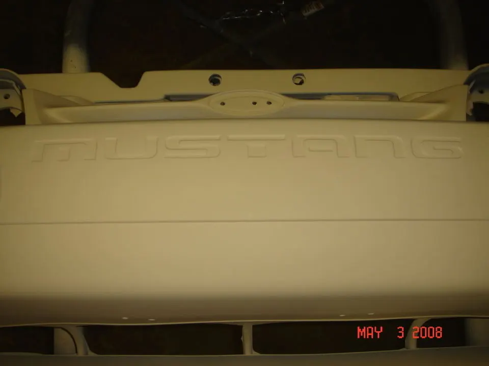

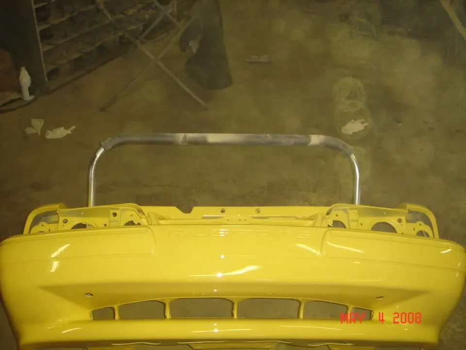

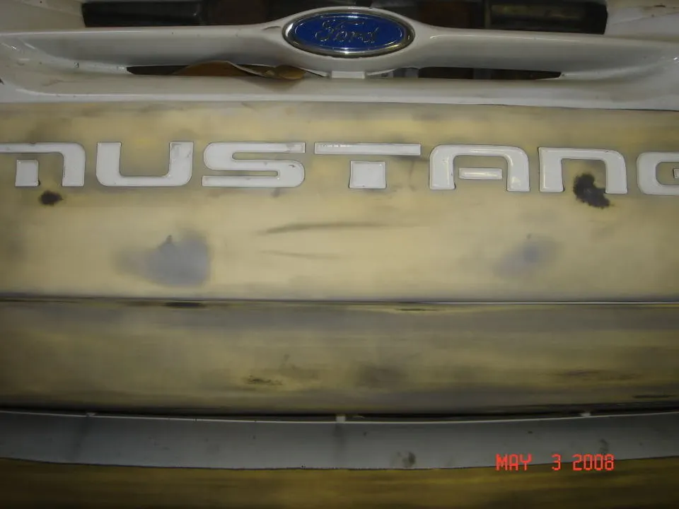

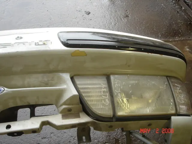

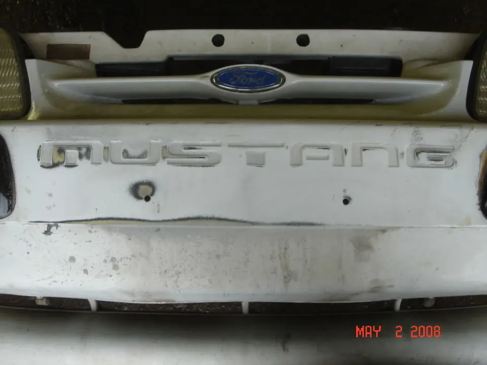

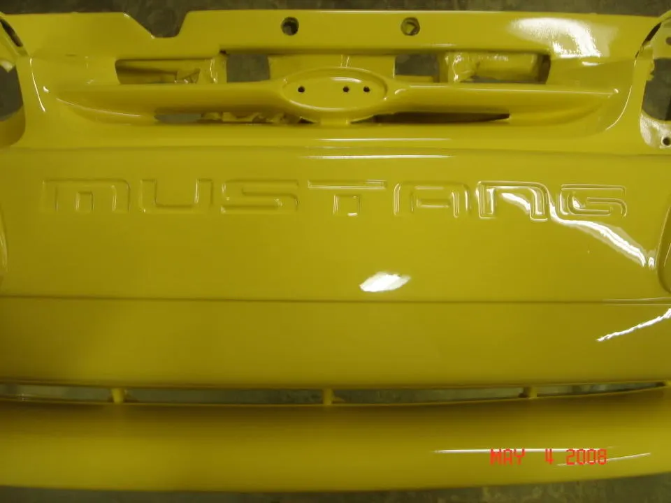

Before
Stripped with 80 grit on a DA
Nason Urethane Ful-Thane 2K Primer
Nason Urethane Ful-Thane 2K Sealer
Nason Urethane Ful-Thane Single Stage paint.
No spider cracks anymore.
I couldnt see any spider webs in the photos but I assume they were there. I will tell my body guy about that stuff and see what he says. I know he i susing base clear, not a single stage but that wont likely matter if the primer is compatible. thanks for the input!!!
