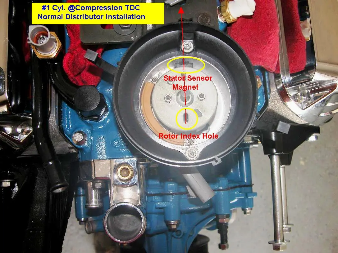

Distributor orientation should be close to this @ TDC.
Gas fouled basically means they are soaked in fuel. Need dry time. :rlaugh:

You need to rotate the engine to find #1 TDC WITHOUT using the harmonic balacer. You have already commented that you previously had someone stab the dizzy while reading the balancer...and then you come back and say the dizzy is now pointing at 8? Grab a long screwdriver and MANUALLY rotate the engine over until #1 reaches TDC. Make sure the driver doesn't bind, but rather slides out of the cyl when the piston contacts it. If the balancer isn't close, it's spun.
My guess is that you fixed the problem...but because the balancer is spun (hypothetical), when you went to re-time the ignition everything is WAY off.
