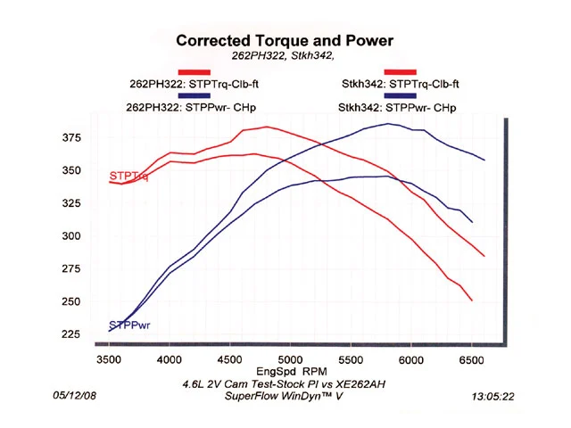

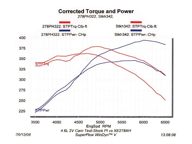

Because a 'stage 3' cam is not always the best thing.
First off the duration of these cams make them incompatable with stock short blocks. They have significant PTV clearance issues / there is no way they are going to work with stock pistons and valves. If you want a 'stage 3' cam you are going to have to open up the block and notch the pistons / change the valves or some combination of the two.
Second when you get such aggressive profiles you start to lose low end power and torque in exchange for gains in the high end- and I'm talking not until 4500 rpm +. So for a daily driver you are going to be driving around a car that is more sluggish than if it had stock cams.... For a drag car the stage 3's make sense because you are getting the biggest gains and combined with some 4.56's you are going to have a beast. But for a daily driven car the couple hp you gain in my mind is not worth the loss in drivability.
See the dyno charts below (These are engine dynos w/ ported heads from the magazine mustangs and fast fords)
'stage I' cams- comp 262's- notice you have gains in hp and torque over the entire rpm range with the peak @ 386hp
'stage 3' cams- comp 278's- notice you have a loss of torque and hp up until 4500rpm, than it opens up with a peak hp of 394hp-but really late in the rpm range.
They even wrote this:
For the vast majority of street applications, the smaller XE262AH would be the clear choice, but the XE278AH cams would likely offer quicker e.t.'s and a higher trap speed if you kept the revs up.
Now I'm not saying the trust the magazines but dyno sheets don't lie.
