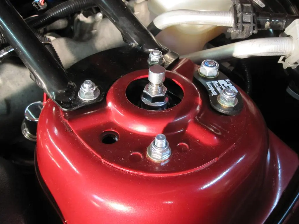

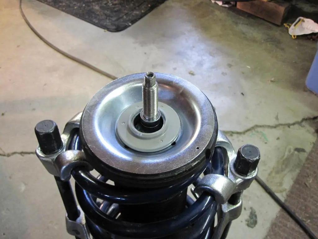

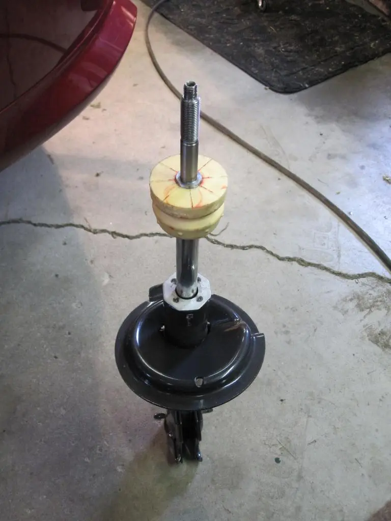

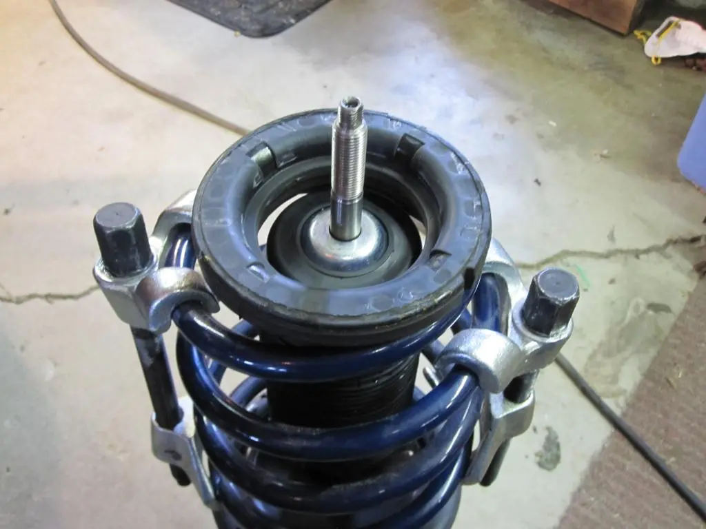

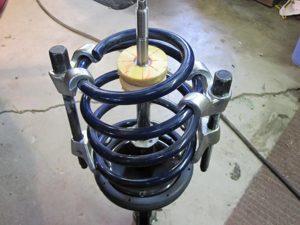

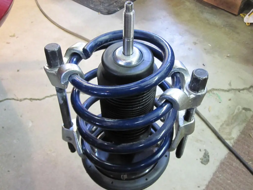

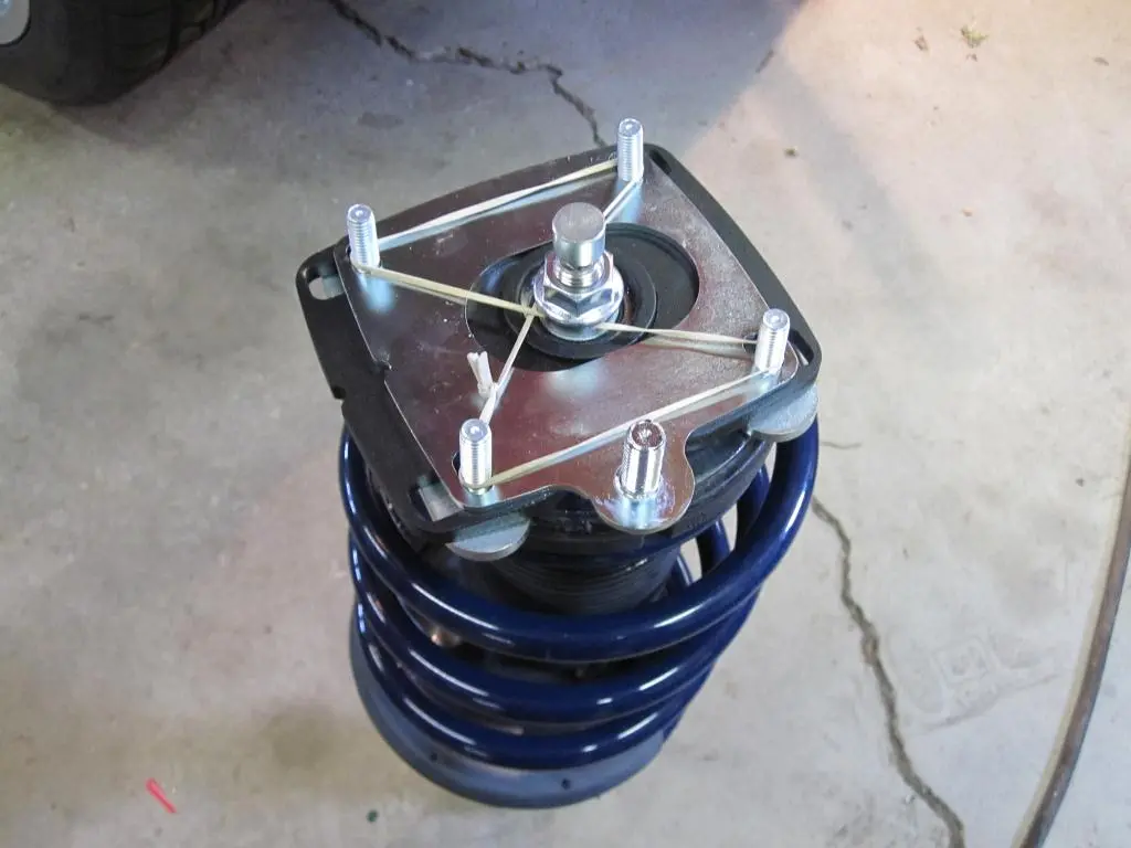

Steve, nothing complicated about the install as it is just like changing springs. I often find it seems like it takes longer to get my car up on jack stands than it actually takes to complete most mods (lowered with BMR K-Member). Once you have the struts and springs out it is basically swapping the strut/spring top plate for the MM caster/camber plate. The MM instructions are very detailed and you should have no difficulty at all with the install. Here are a couple of pictures starting with the bare strut.
Strut with jounce bumper installed:
Spring installed:
Dust cover installed:
Spring insulator installed:
MM bottom plate:
MM top plate installed with elastics ready for sliding into position on the car:
Installed:
