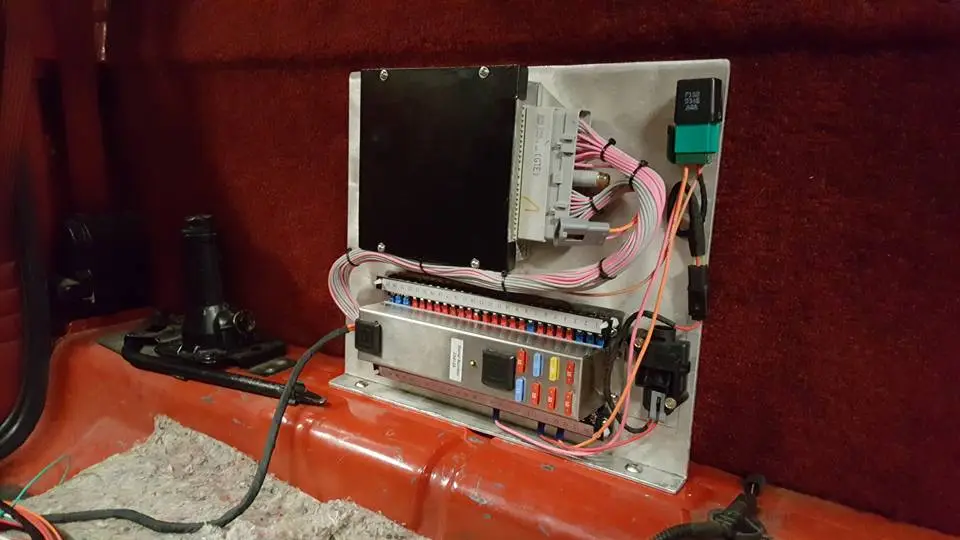

You can't just say: 'I like this' and not at least give us a link. lol
What are the pros and cons?

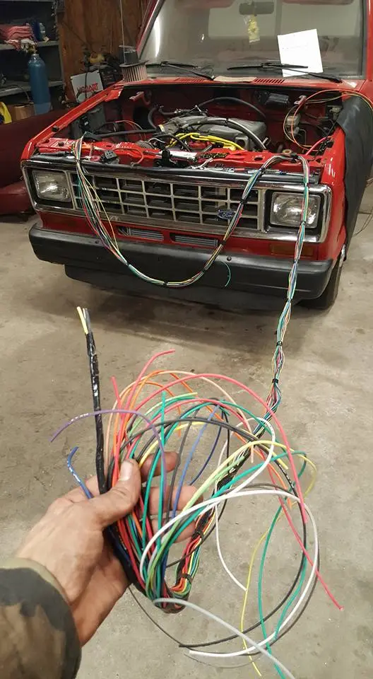

It's a nice replacement for a factory harness. In my case I had plenty of room to mount the Telorvek panel behind my seat (it's in a 5.0 Ford Ranger) so in cars you may have different obstacles. The only con I can see is there is no connector to unplug the harness from the engine if you have to pull the engine from the truck/car. You'd have to unplug every single sensor, etc.
That could be solved easily though, by using some large deutsch connectors. Something like this: https://www.te.com/usa-en/product-C...ts&samples=N&inStoreWithoutPL=false&instock=N
Here is the specific harness I used: https://www.ronfrancis.com/prodinfo.asp?number=MG-70
In case anyone is interested..
The wires are SUPER long so they'll fit in any application.
The panel behind the seat during install

So the 'con' there if there is one, is that it's a one-size-fits-all kind of thing.
The only reason that I say that is because I thought it might have been a Mustang specific harness (super difficult to find these days for Fox and SN at least).
Ron Francis makes other more simplified harnesses that would likely be a very good fit for the Foxbody, and they're cheaper than the Telorvek version. I believe they're direct copies of the old Ford Racing EFI harness.
