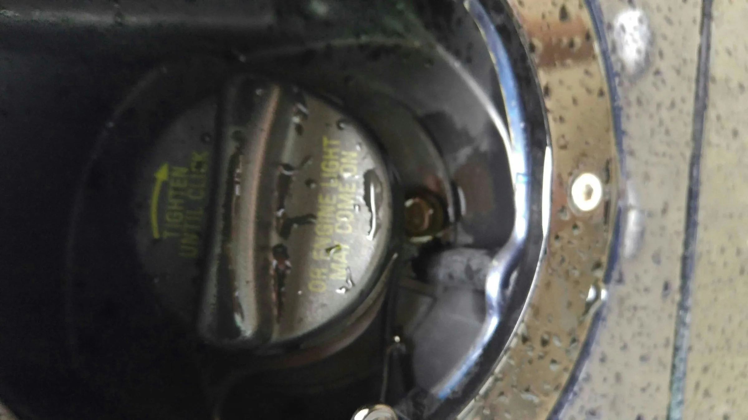

The cap I dunno what to do, it's entirely custom, lemme grab a pic for you maybe someone is familiar. Is there a way to mess with the sensor so it thinks it's closed all the time? I want to keep this custom one, just needs touch up paint work. I've never used a custom fuel door of any kind on any car, not familiar at all with how it senses it being open or shut.
The original fuel cap screws into the tank filler neck. This ensures a good seal. The reason a cap throws a code is it fails this sealing task which limits the fuel systems ability to function properly. Normally takes a couple of start cycles for the system to reset.
Thats just exterior you need to replace the cap

Ooh, okay, total brain fart here, confusing fuel door with fuel cap, my bad, yeah I'll do that first thing, looks cheap enough. I'll have my buddy check it over when we do the battery and new terminals tomorrow, thank you. I just assumed the cap was fine, was focused on the door because it's not stock. Thanks again ;)

Under the fuel door the cap looks totally stock, like the image posted above by Jeno.
