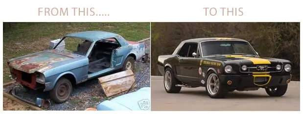

I'm pretty sure I know what I want. See the attached pic. I have a 351W and T5 sitting around that I'd like use in it. I'd like to run it at the dragstrip or road course on weekends. I guess I need to make a list of exactly how I want it. It'll take me a few years to complete for sure. I have other Stangs to drive so I can focus on doing this right.

Is the after picture a Dallas Mustang's reproduction of the Teralingua (sp?) ?
Very nice direction to go in my opinion.
I think I saw on their site that they are selling their versions of this car for $78,000 !
I would assume that Dallas Mustang has most of the parts available to build the car you desire.

steemin - Yep, that pic is of the Dallas Mustang DM-450. Retailing for $78k... yikes! I won't be able to build one of that level. I like the nice simple look along with the power and handling.
