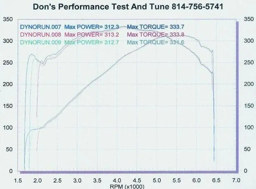

I tryed a fre different calculators to calculate shift points for my car but looks like they all littlebit different
So i wanna ask you guys because you guys must know this better then anyone
I have 94 Mustang GT convertible 5 speed that weight about 4000lbs (don't ask me how, ithave cage,subframes ,i weight 320lbs)
I have stock 302 bottom end , TFS TW heads ,AFM B-31 cam, TKO500 (3.27 1.97 1.34 1.0 0.68 REV 3.00)
3.73s , 315/35/17 Nitto DRs which are 25.7 Overall Diameter
Here is my latest dyno
Thank you a lot
