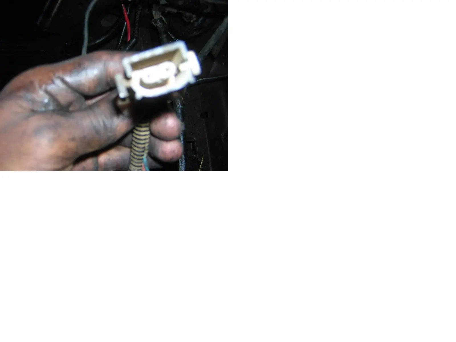

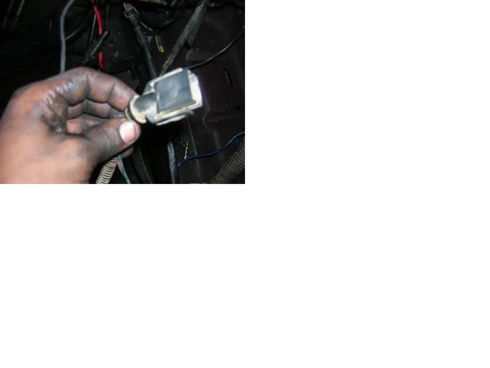

the harness came out of an 88 coupe, and the plug is white.. on our cars do we have a plug that goes to the power steerin hose? the hose in my car has a spot for a connecter but on my 5.0 harness i can find what goes to it..
jstang209 said:
u talkin about the white bottle.. i looked all over mines and theres no place for a connection on it!
:shrug: :shrug: :shrug:
I just went outside and pulled the plug off my overflow and that is it, it has those two little pin holes in it just like your'e first pic. Is your car a 4cyl swap car? Maybe that has something to do with it?
I think my overflow tank plug looks different than that? Probably because it is a 4 cylinder car your looking at.
Just a FYI, but I have fog light wiring harness connectors on my Lx.
Pic on the left is for fog lights. You'll find another one on the pass side.
Pic on the right is coolant overflow sensor.
If you install the GT warning light setup, you can install the coolant sensor and get it to work.
I have done that myself.
