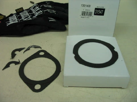

Try these...Its what i use...the P/N you see on the box should be a good number.I trim the holes out, loosen the connection enuf to slide them in...should cure it...
