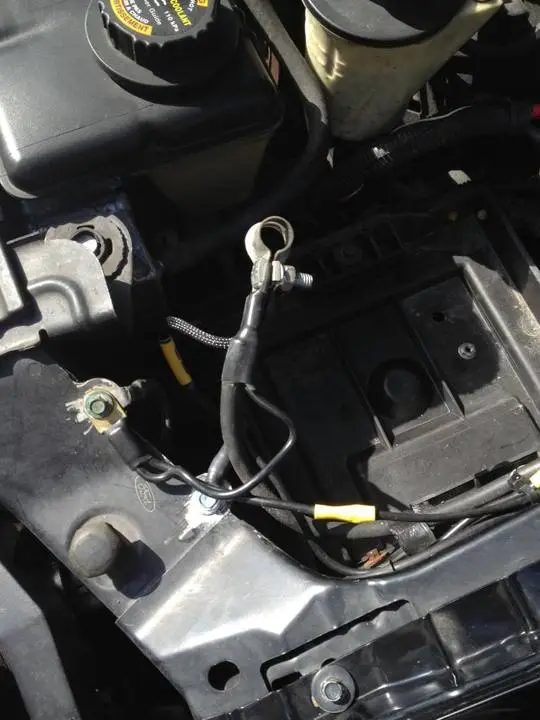

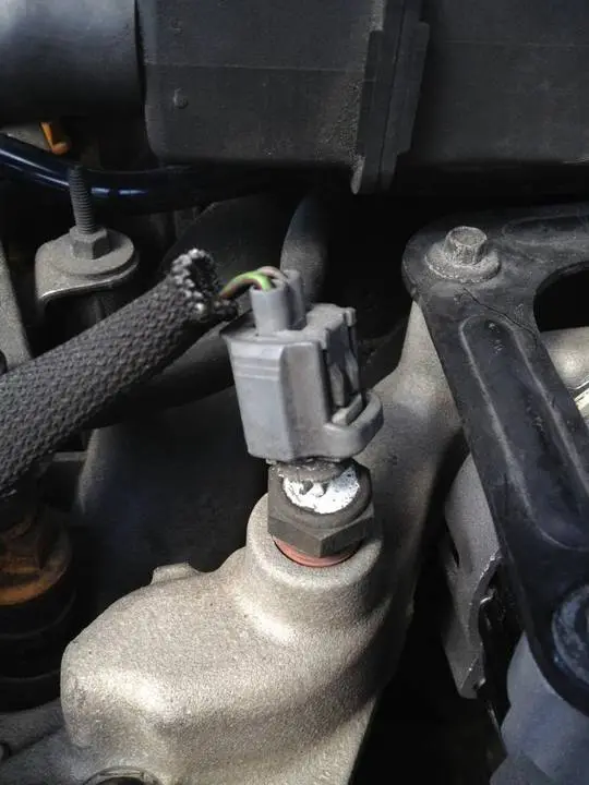

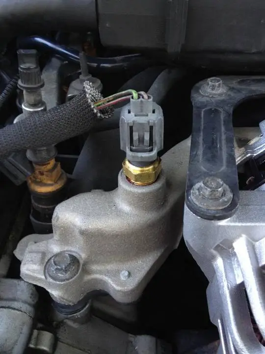

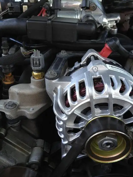

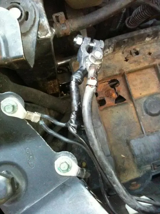

My 99 GT had a battery drain when I purchased the car. The previous owner was more clueless than me (bad tune, bad engine ground, did not care about battery drain) so I got a good deal on the car and quickly fixed the engine ground and found the drain (with the help of members on this forum, especially wmburns). I have not had any electrical problems since that drain other than slight rpm reduction/lights dimming when I put windows down. Fast forward to this week when I talked my wife into taking a road trip in the Mustang. I rarely use my AC so I had it on full blast on the highway. All of a sudden my battery gauge went to 0 and soon I was rolling to a stop on the highway with a bad alternator and dead battery. I started by having the battery checked and fully charged by Autozone, no problem there. I had the alternator tested at Advance Auto and it was bad so I bought a remanufactured alternator and installed it today (thanks to this forum again). When I was installing the new alt, I noticed the coolant temp sensor was toast (picture below). I thought it might not be a coincidence that the alt went and the coolant temp sensor went at the same time. After I installed all this, I took the car to have the battery and charging system tested at Advance Auto. Advance said the battery is good but the alt is at 12.4 volts without headlights on and 12.8 with headlights on. The guy there said I might need a different new alternator and that it is weird voltage went up but he had no clue why. I should have had alt checked before I installed but it was the only one there. Also, when I turned the AC on, the car slowly stalled and died (I had this issue before but my tuner fixed the issue). His idea is that my AC clutch/compressor is bad and it is causing massive drag, enough to completely kill my car. There is some good news since new alternator was installed (although with voltage where it is, I'm not sure if that's the reason). When I used to turn my lights on or roll my windows down, there would be an RPM reduction, now the RPM doesn't change at all when I have headlights on or put windows down. I have searched the forums and checked connections but was wondering if anyone has any ideas.

Old Ground/Tray:
New Ground/Tray:
Old Sensor:
New Sensor:
New Alt/Sensor:

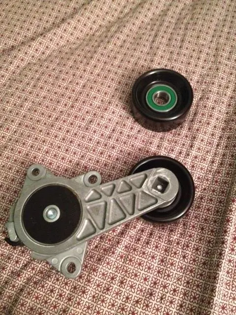

Trinity, my plan is to check all the pulleys while the alternator is out. I already can tell that the upper idler pulley is a bit wobbly and I may need a new tensioner pulley (missing the bolt to release tension, had to use a temp bolt). Once I have checked/replaced the pulleys, I'm going to decide whether to get a new compressor or run the car without AC. I was trying to connect the dots on the AC/Alt going bad and complete battery drain but based on what you're saying they may not be related. I just think it's weird that I never run my AC but when I did on the highway the alt went bad. I have been daily driving the car every day to work (short distance & not using AC) for the past 9 months or so with no battery/alt issues. Anyway, starting fresh with new battery, new alt and pulleys should be a good start but I think I need to start searching for a short in the electrical system.

The pulley seems smooth. The idler pulley was wobbly though and tensioner was missing a bolt so I picked these up:
Rereading your issue, if the car is shutting down, then yes there is an electrical fault somewhere. It may just be coincidence that the AC was on when it shutdown. The plug to the coolant sensor might be a clue. I'm surprised you aren't having fuses blow...but then again maybe not. I had an issue with my 96. Driving down the road and it would just shut down. The last time it happened I had to have it towed home. At this point it was blowing a PCM fuse. One of those big 40 amp boogers. It was also setting off the theft system and counting the theft light blinks it was telling me no communication with the PCM (obviously). I looked backed on what had been done to the car recently and I had the transmission repaired after I broke a shift fork. So I crawled under the car and found one of the O2 sensor wires was rubbing on the tray the supported the connector. It had worn to bare wire. I taped it up with electrical tape, replaced the fuse and it fired up with no more issues.
You may have an intermittent short similar to what I had. Movement of the car will manipulate the wire causing the short one minute and it will be fine the next. Think about any work you had done recently and work your way from there. I'd pay particular attention to the coolant sensor wire 1st.
Thanks for the info. Ill def check where some recent work was done. Got the new battery, alt and idler pulley in, battery tested at 12.94 volts, 13.97 with no load and 13.9 with high beams. AC definitely an issue so not worried about it until I fix it. Thanks for the help everyone.
