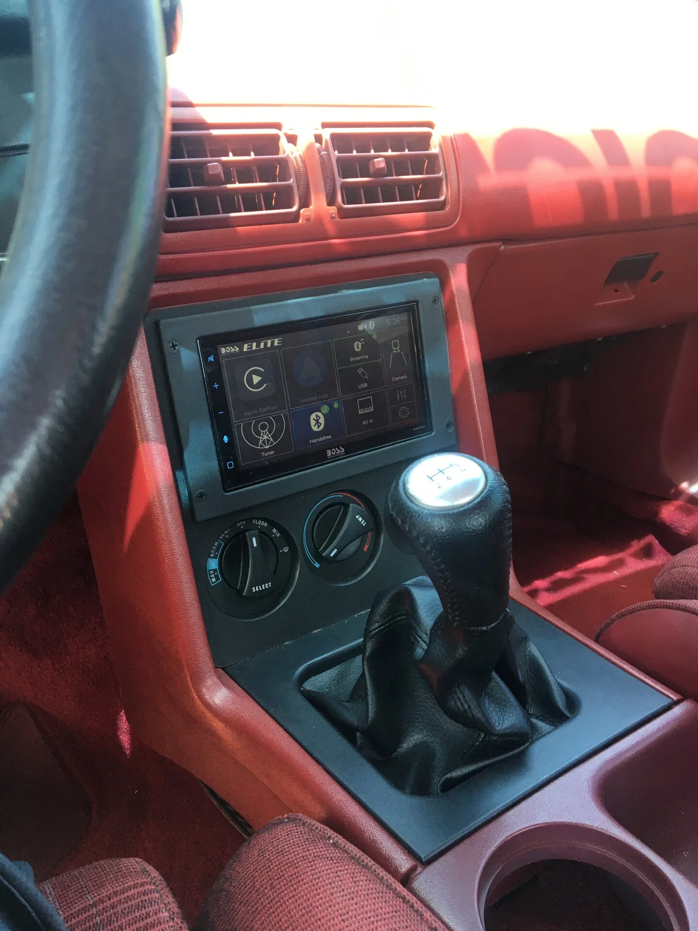

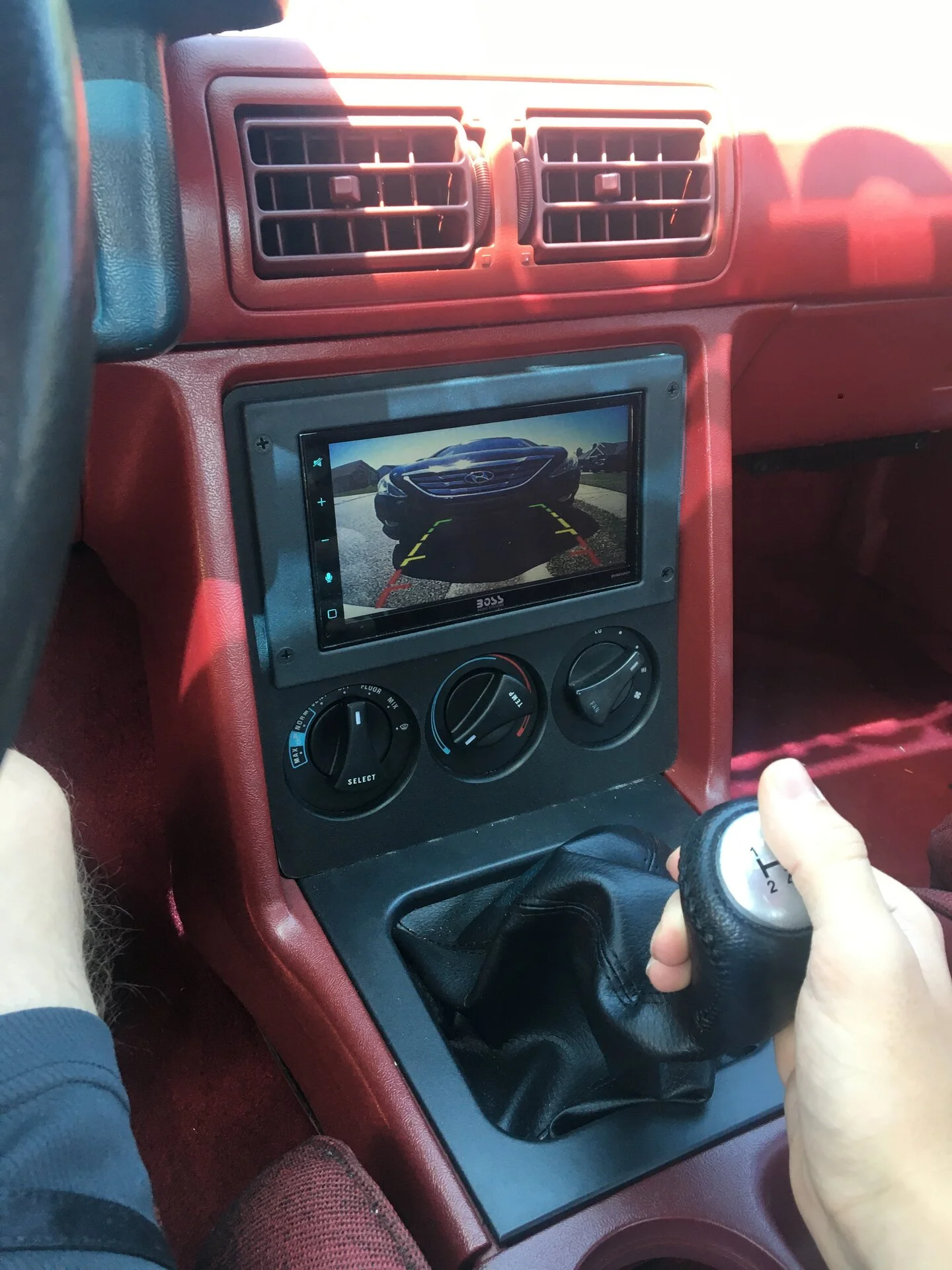

PS, here's my radio setup, relocated HVAC, got a 10" sub and amp in the spare tire location, even got a rear view camera going in there. only a little proud of it :D

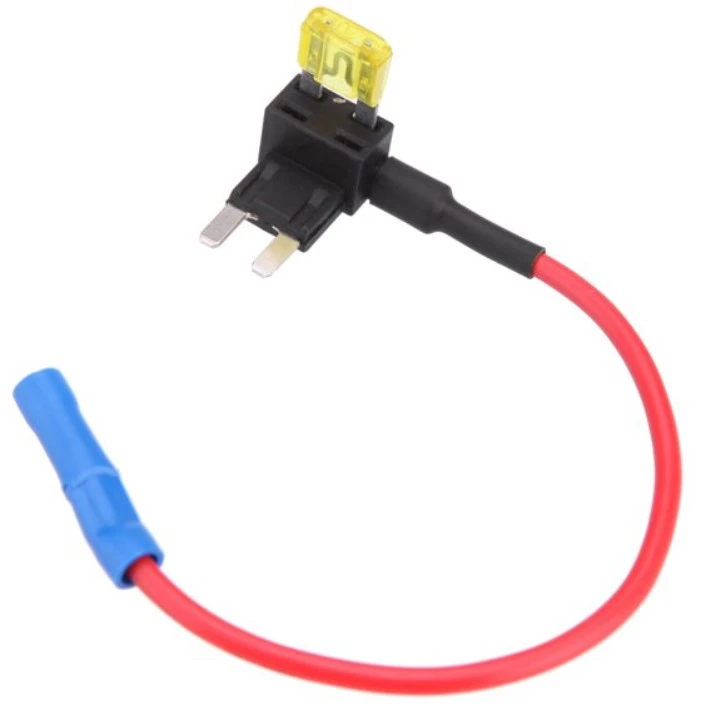

Whatever circuit you have your memory wire on could be your issue..Lots just take the wire and wrap it around a fuse and over time that spreads the terminal out causing an intermittent connection..They have piggyback adapters for that task..

If the memory wire is wrapped around a fuse its most likely the fuelpump fuse....Fuelpumps pull a bigger load when first started after sitting....
When I do an aftermarket Double Din stereo install I buy the interface wires that hook into the stock stereo plugs and allow it to interface with the deck..
