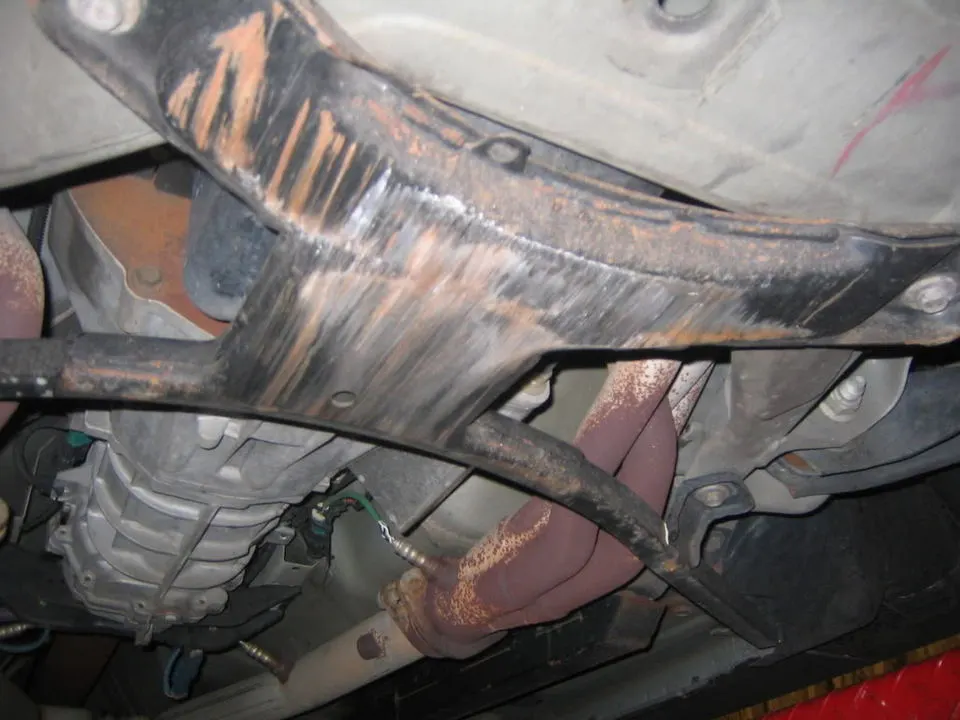

It's possible. You have a convertible...a New Edge convertible. Not exactly bastions of rigidity at the best of times, probably flopping around without that support. If you're talking about this:
then yes, put it back on and get back to us.
