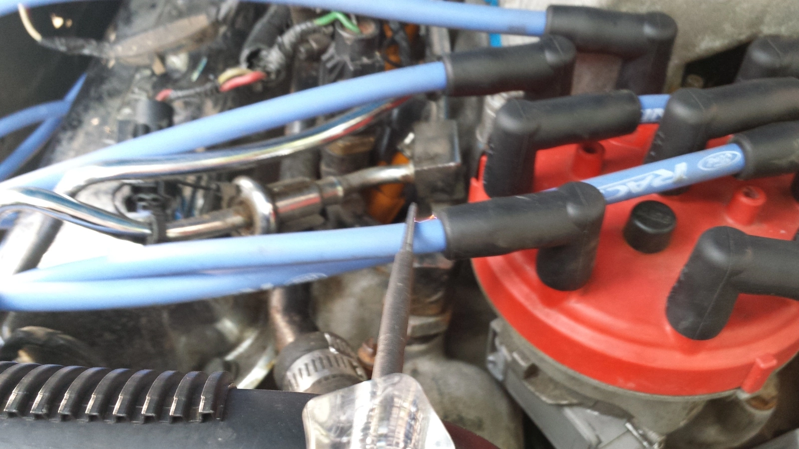

I decided to take a test light hooked up to ground and see if I could fine spark arcing out anywhere. This is what I found. Could this be the cause of my problem? This set of wires is a week old. I cant hear or see it without putting something against the wire but as you can see from the pic its def arching off. Its so small I almost feel like thats not the cause.

I would return those to the place that they were purchased. They shouldn't be doing that.

Within 15 mins of discovery I had a return slip, they were boxed up, and dropped off at ups. Should I order another set of Ford racing wires or is there a better option around the same price point?

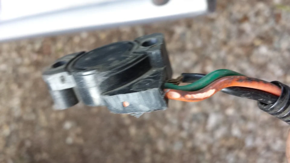

This is what the tps looked like. Def needs replacing but could heat cause it to get all screwy?

Do you have an A9L or A9P EEC? That TPS looks more like someone messed with it than melting. Slap a new one one, do a base idle reset and as long as the TPS voltage is between .50 and 1.1 with the throttle closed your good. On afermarket TPS, you may need to open up the screw holes so you can wiggle the TPS to get it within that range. Do not worry about getting the magical .999 setting. It doesn't matter.

Its an a9l. It looks like the previous owner sanded/ground down the tps in an attempt to get a little more adjustment out of it. In the process they went to far and pulled one of the wires out kinda far.
