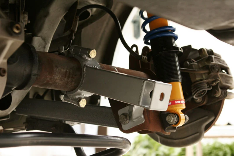

It ended up being the fuel pump. I installed a SVT focus pump. That should take care of me when I add the blower next year. While I had it up, I installed my Griggs Racing LCAs, koni coil overs, and the axle mount for the PHB. I'll install the over half of the PHB next week along with the torque arm...
Thanks for all of your help!
