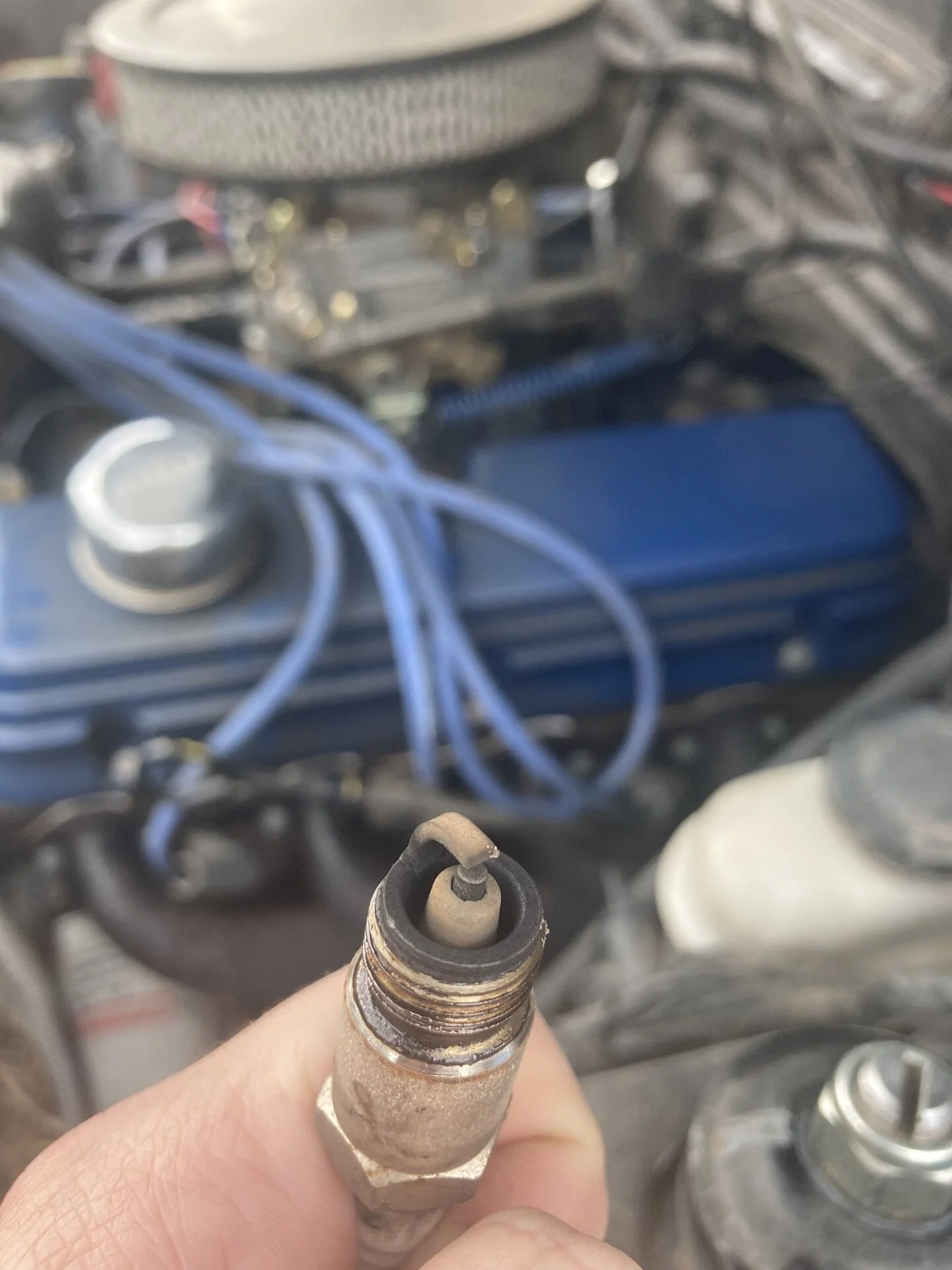

This is a plug from the driverside closest to firewall.. Ill pull a few more to see if they all look the same. But how does this plug look to yall?

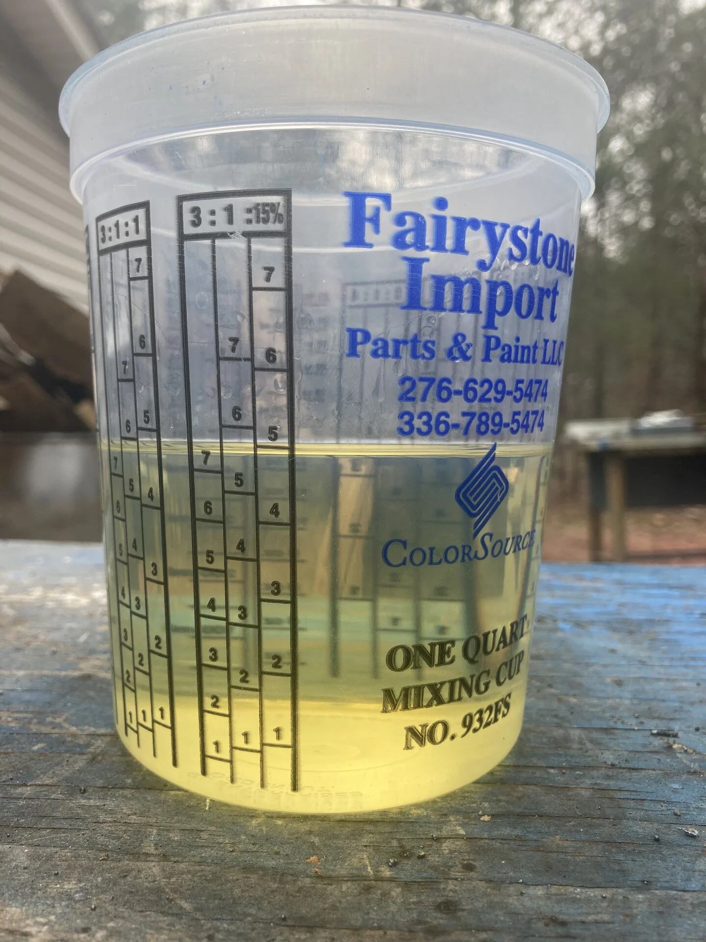

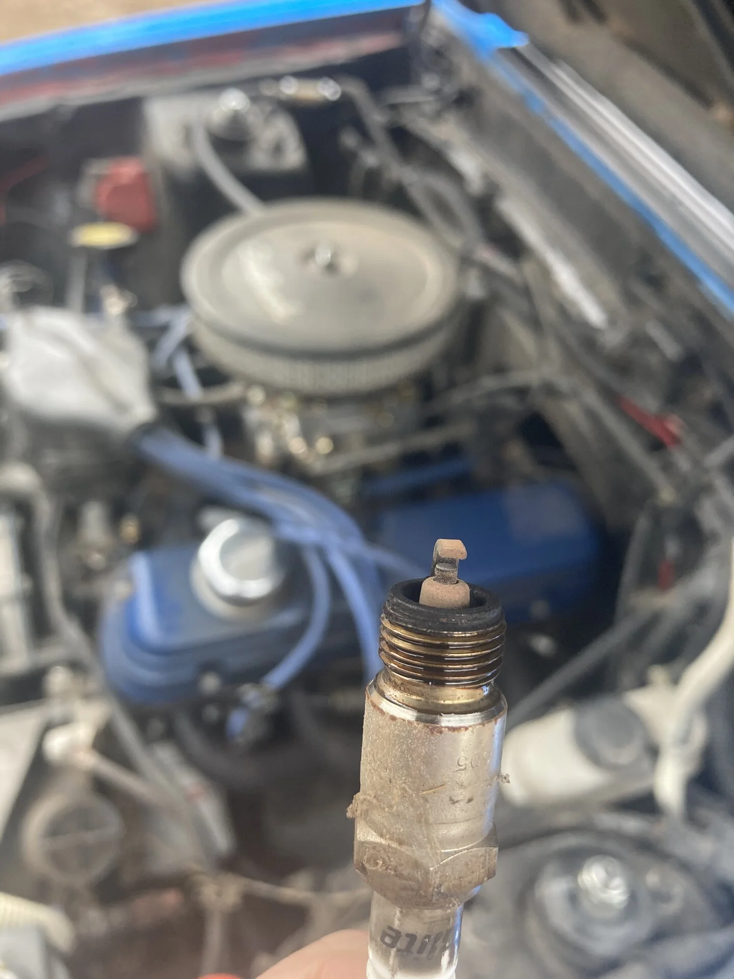

This is another plug i pulled and the gas i drained from carb a couple times..

Plugs don't look too bad but there seems to be quite a bit of tan / ash deposit.
I would get a new set , gap and install then see where your're at.
