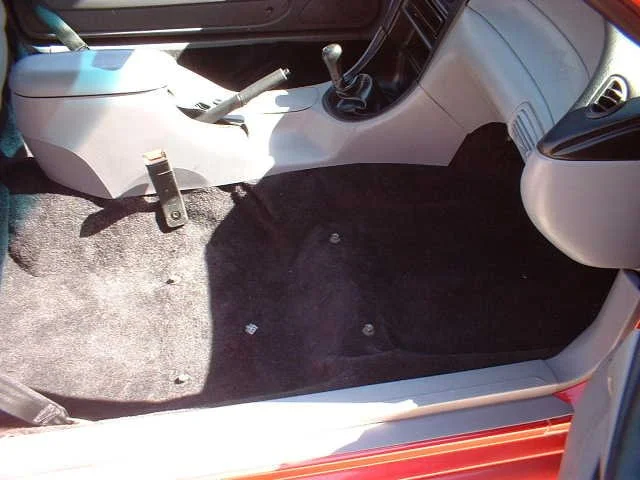

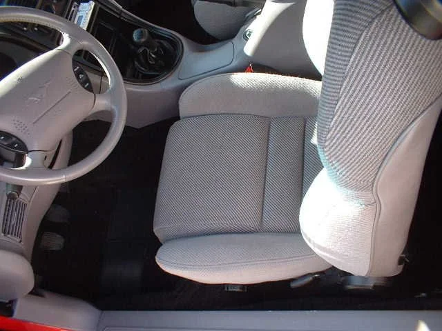

I put black carpet in mine, which is grey/black 2-tone. It orginally had grey carpet that got real nasty due to some water damage. I completely stripped the interior and washed the floorpan down good. I figured that since I had it apart I would dynamat the easy to do surfaces to cut down on noise (I actually used FatMat, its cheaper and just as good as dynamat).
You have to cut all the holes for the seat bolts, electrical connections for seats/driver seatbelt, the seat belt bolts, and the clips for the rear seats. You'll also have to remove some material around the center console & footwells. Remember measure twice, cut once.
I originally didnt use adhesive, but I wished I would have. After a couple months the carpet started bunching up in a couple spots, and it looked kinda rigged. I got some carpet/headliner adhesive from the local auto parts store and re-installed the carpet. I put down the adhesive only in the spots that tended to get wear (mostly footwells), so that way it wasnt insanely hard to remove the carpet if I ever had to take it out again. Overall I think a new carpet, especially in black, makes any color interior look 100x better.
This was before I used the adhesive.
