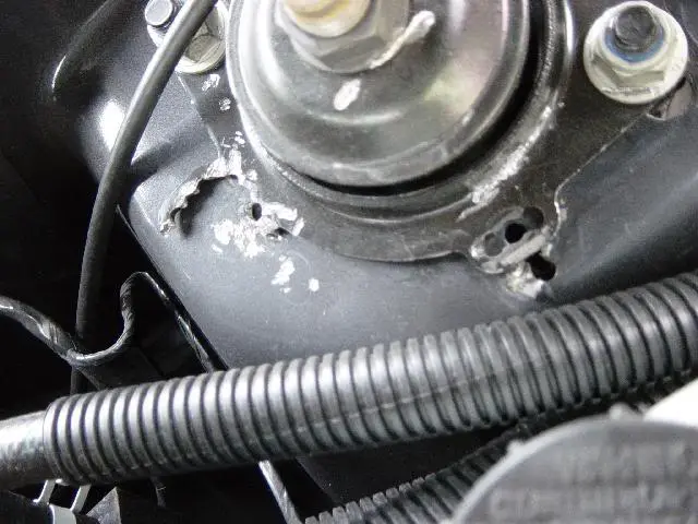

You know... with a little bit of care you can modify your stock plates for a bigger range.
Just don't mangle them like this (unknown) guy did...
