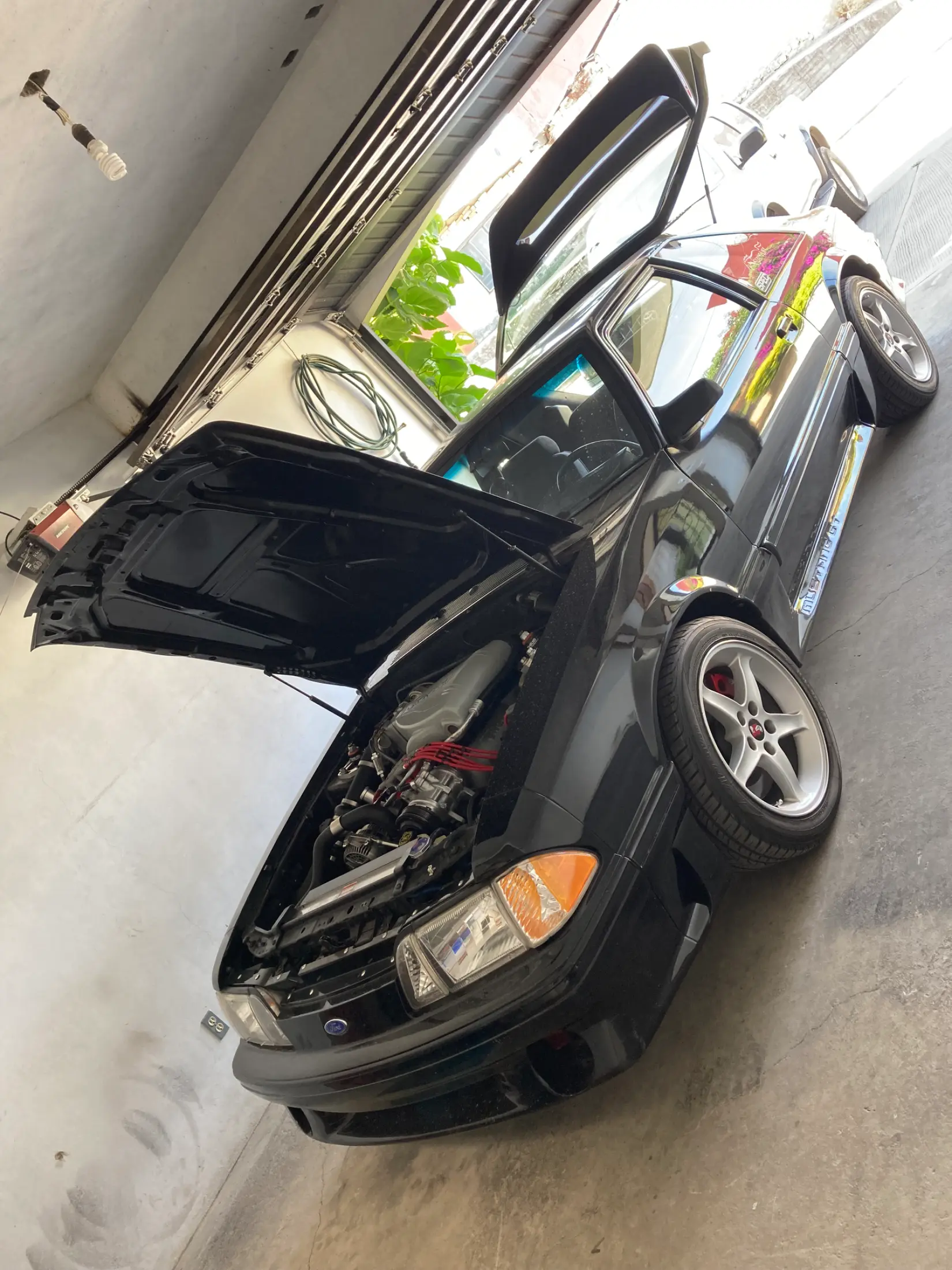

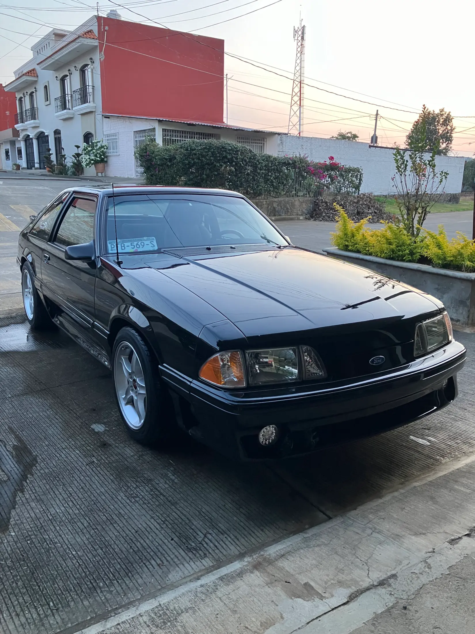

You’re 100% sure the springs are the pro kit and not the sportlines? Pic of the car at ride height?

Now you made me wonder about which ones I have. I will double check the receipt to make sure and will post a replay with a confirmation.

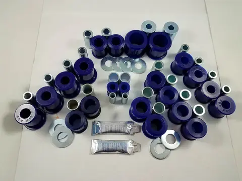

I ran the urethane bushings for about a week when I daily drove my Coupe. Absolutely terrible. This was with H&R Super Sport springs and Tokico Illumina dampers. Also had stock rear uppers and MM lowers blah blah blah. Put Moog rubber bushings back in the front control arms and in the rear axle and it was night and day difference.
I have pro-kit springs and bilstiens on my SN95 and the ride is rather fantastic. Firm and certainly not harsh. Granted SN95 and Fox ride a little bit differently
However I think your issue is the poly bushings. One of the tradeoffs with them is NVH. You’ll get fantastic handling but at a cost.
I would actually start at the axle bushings and replace those poly bushings with rubber and see if that helps any. These 4-links are prone to bind when you put too much poly in them which is why MM recommends stock rubber bushings for the upper arms and in the axle.
Probably you’re right with these prothane bushings it gives me superb handling and no positive toe or deflection under hard braking and no rolling while turning at high speed.
So I might have to orderfrontblower control arms with stock rubber bushings

My rule on bushings is any twisting movement and they get rubber, any others get poly...

Came to this conclusion after my first Poly suspension.... The squeaking was like chinese water torture..... Now we read about how the poly bushings actually can crumble away.... live and learn
That’s funny, I pressed in those red prothane bushings around 15 years ago and not a single squeak in all of these years and still not crumbling at all, they still perfect.
There are an infinite variety of polyurethane bushings out there which I will never buy, some of them are hard as a rock and they are just garbage.
I use Prothane and Energy Suspension and they hold years without issues from control arm bushings and manual transmission mount and cross member bushings.
