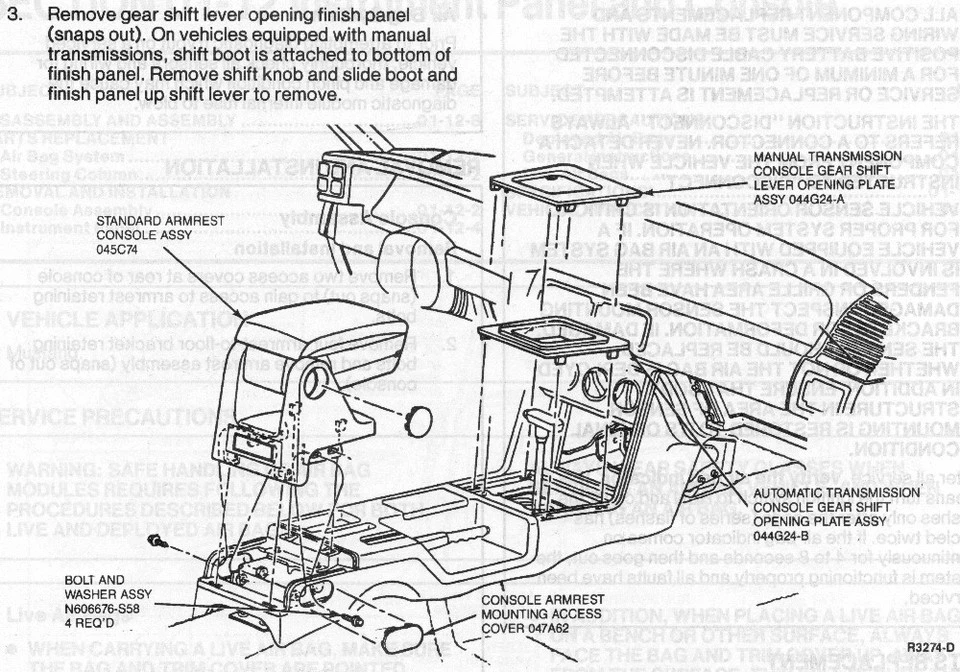

Just boughr an 90 LX 5.0 and the armrest was taken off the center console and for the life of me I can't figure how the rods/bushings install.Recieved copies of Chiltons and Haynes with the car but they only show the console. Would anyone have an exploded view of it?Thanks Tons.

This is the only image I could come up with. It's right out of the Ford Mustang Service Manual.
