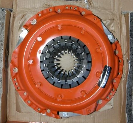

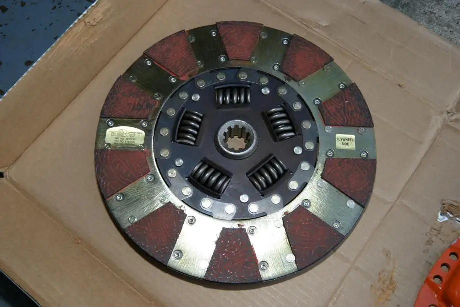

here is a photo of the current clutch.. is it good or bad?
Let's see a picture of the pressure plate. You know, the orange thing we can barely see next to your clutch in the pic you posted. Take a pic of it with the smooth side down just like it's sitting there in the pic.
