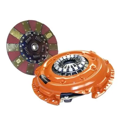

I run the Centerforce DF.
Pedal is nice and light.
I don't have a great deal of engine, so I can't comment on that.
I checked your link to the Ram.
That thing is a dual disc unit, not just a dual friction.
I don't see any weights either like the CF.
I think that Ram is a whole different sort of setup.
The CF has weights that spin outward as rpms increase to put more pressure on the disc. That is the CF claim to fame.
Personally I like it.
I have had some really strong clutches before, and pedal pressure can get crazy.
Not so with the CF.

My CF experience after 2 years of use with a similar motor--Light pedal, great street manners, a dream to drive. Most people swear by them.
There is also a group of racers that have had problems with them and will never go back.
Once I started running it real hard on the track (after 30+ runs with DOT slicks), it grazed over and started to loose its effectiveness and would slip some between gear changes. Problem got worse over time. Still ran great otherwise without the slicks. This DF unit is now sitting on the shelf as track usage is now a major concern for me, especially since I have mounted real drag slicks for the next trip.
If you are going to stay mostly street, the DF will work for you, and I totally recommend it for a car without slicks. If you are going to have a track only car, look at the sintered disk stuff from Mcleod. If you have a dual usage street/strip car, there is no real clear answer as to what will work best.
