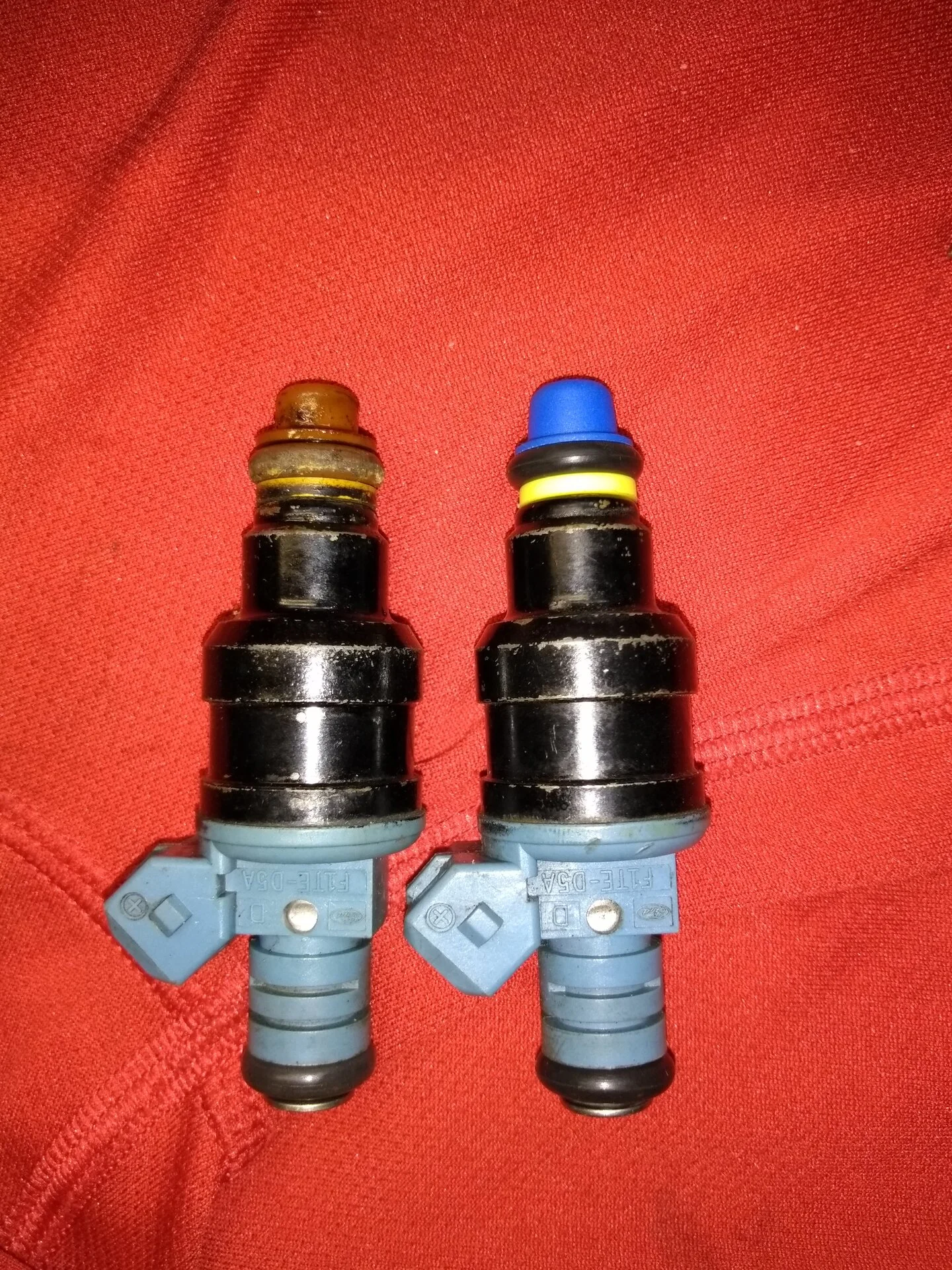

Hey guys,
Looks like I have a massive lower intake gasket leak. Right behind the distributor on the block where rtv goes.
Just looking for tips and advice. My first time doing it. I planned on changing out fuel injector o-rings, distributor o-ring while I'm at it.
I have fel pro 1550S-3 gaskets, arp intake bolts, and right stuff rtv.
Thanks for any help you can provide.

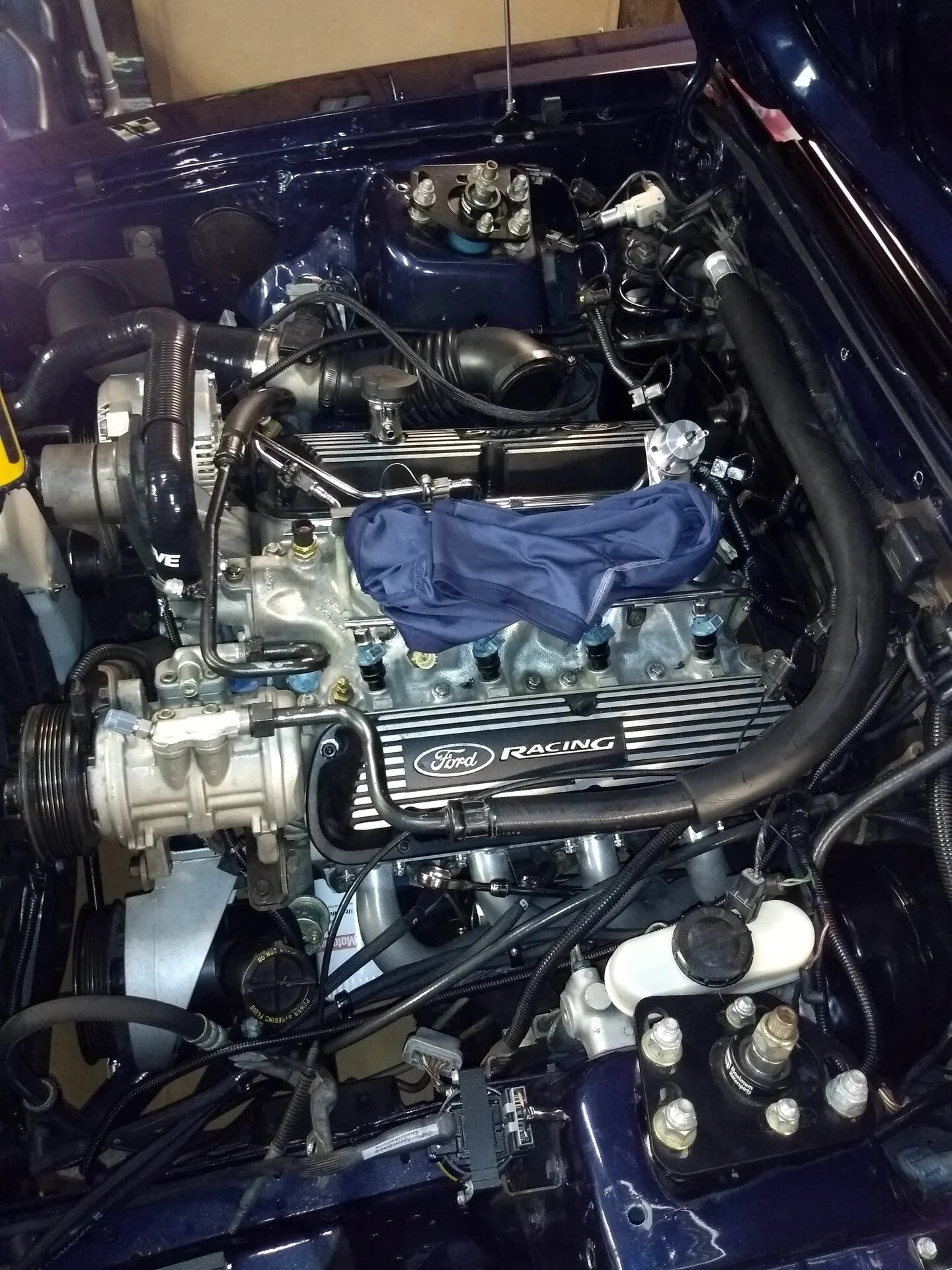

Little done today. I don't have a schrader valve on fuel rail. So I'll wait awhile and let pressure settle on it's own.

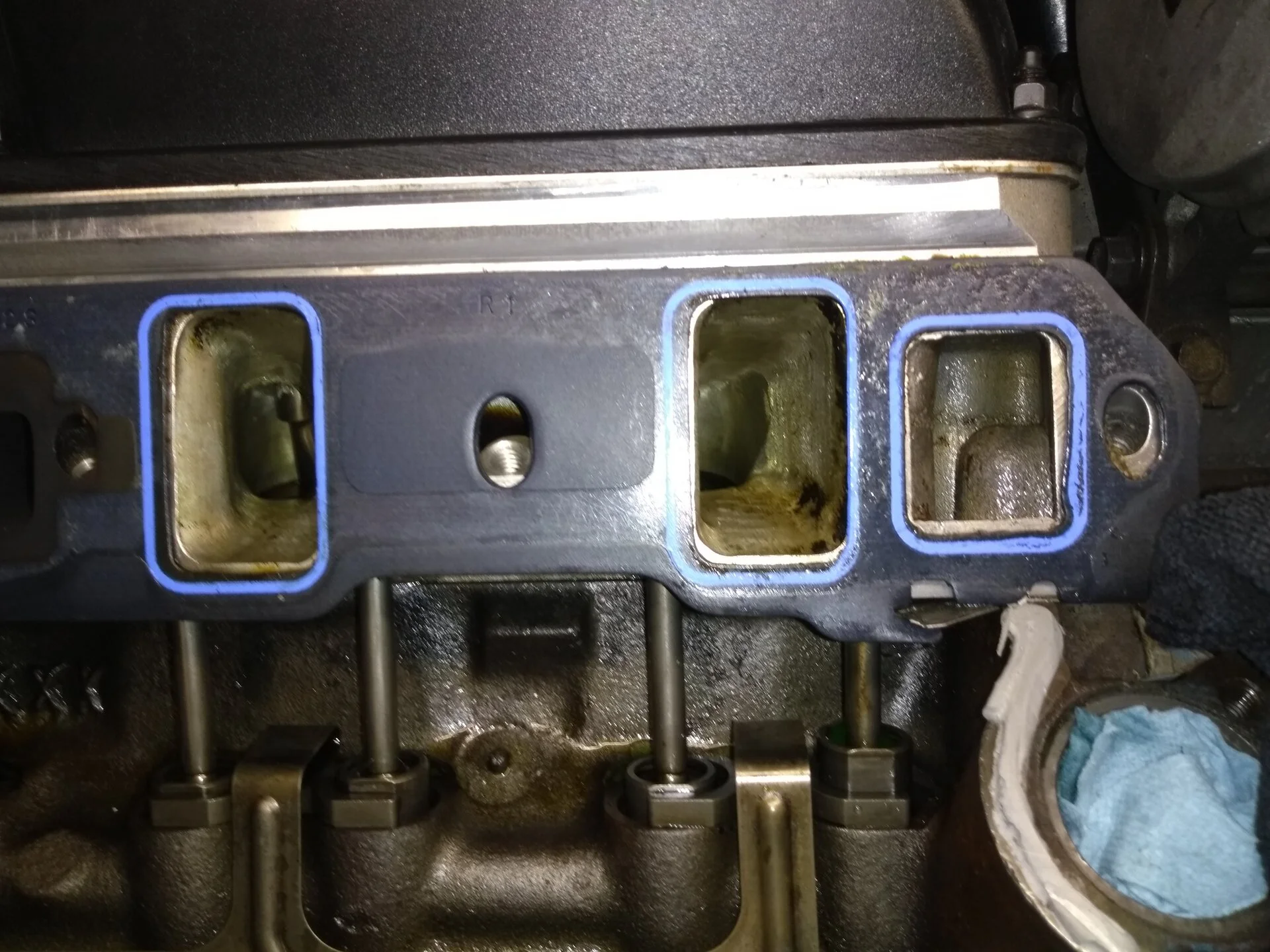

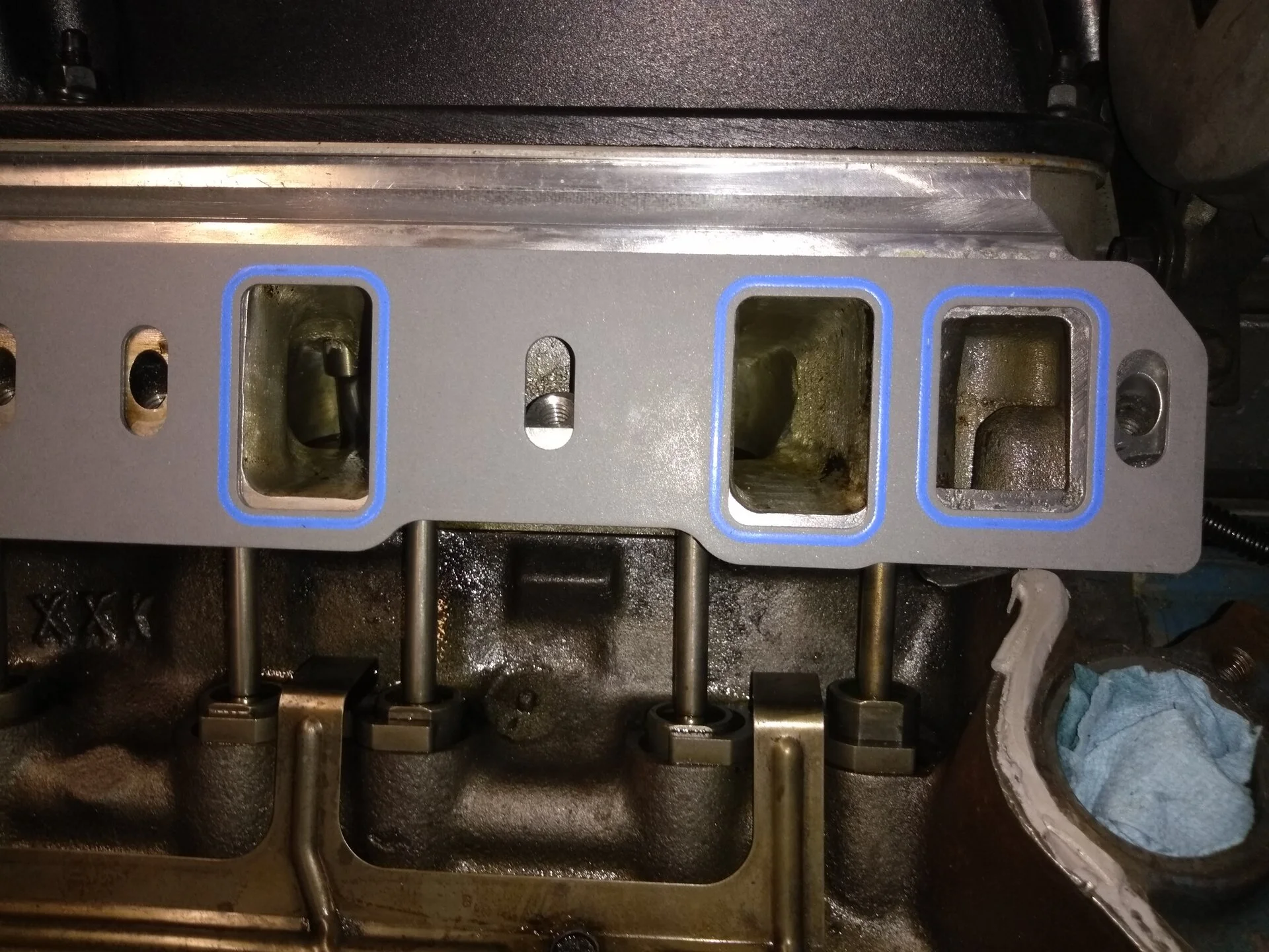

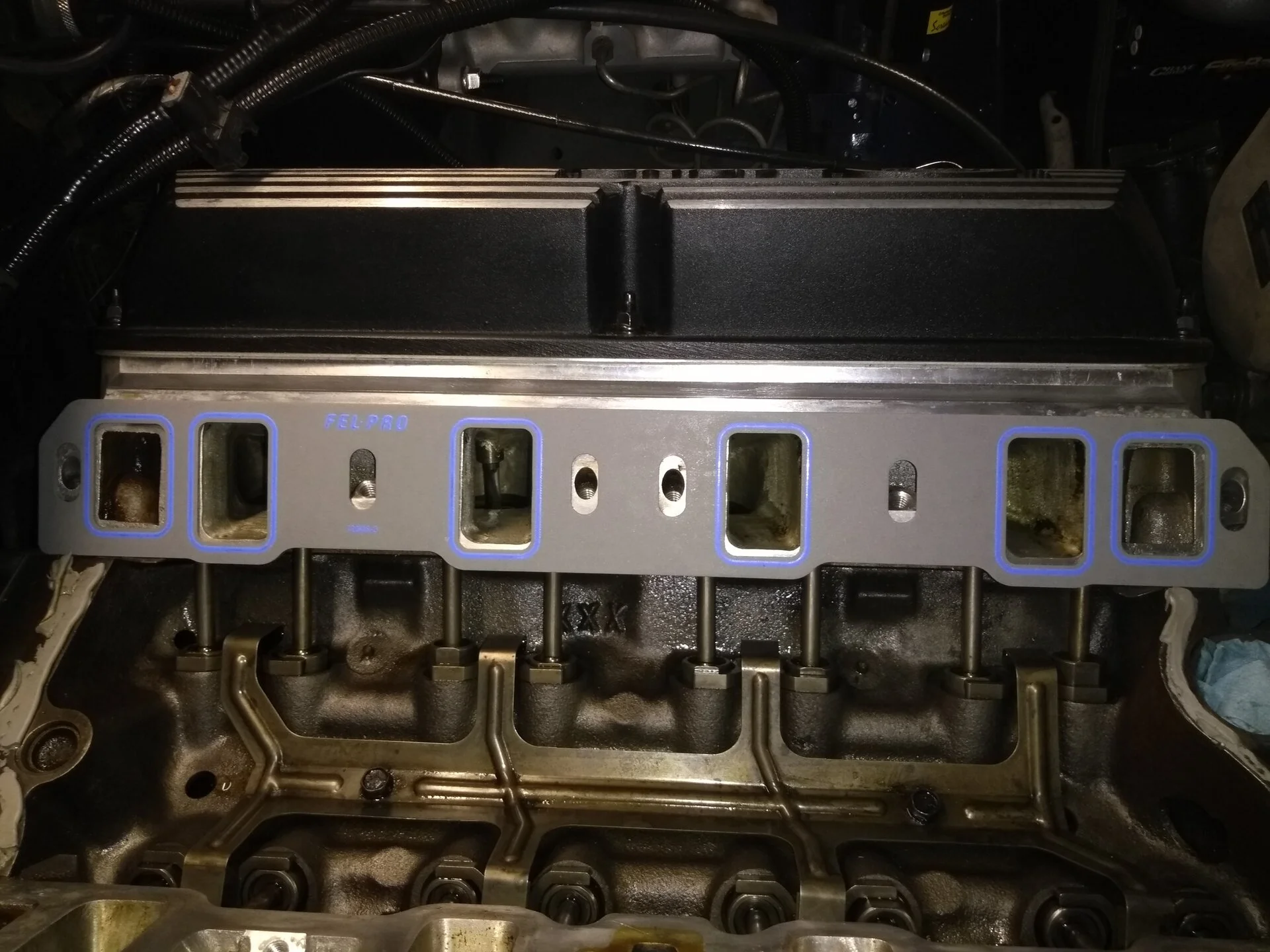

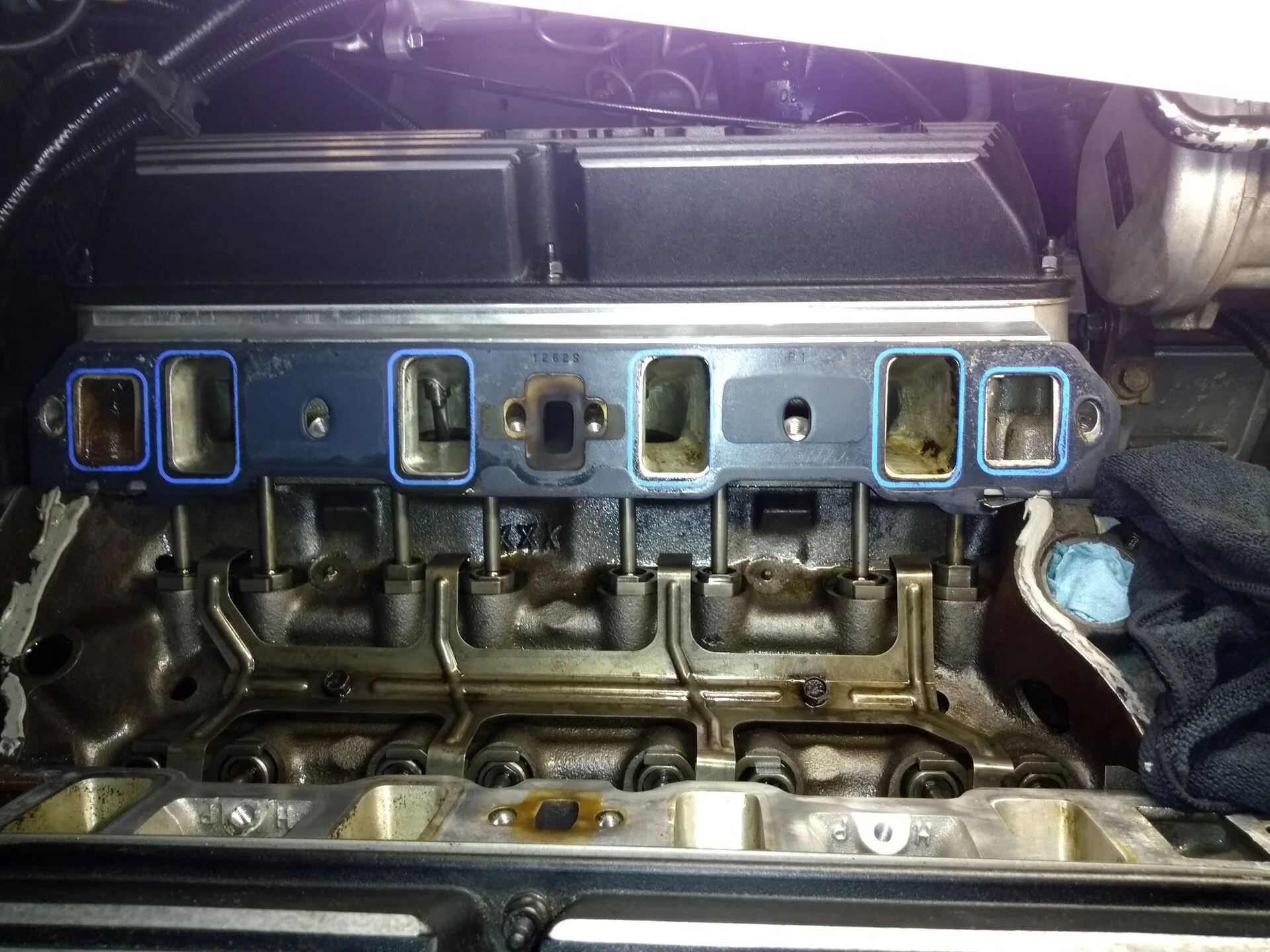

Hey guys,
I need some opinions on gaskets. My car had fel pro 1262s gaskets. I have 1250s3 right now.
Pictures below, should I order the 1262s?
Or will these work if I get them moved up?

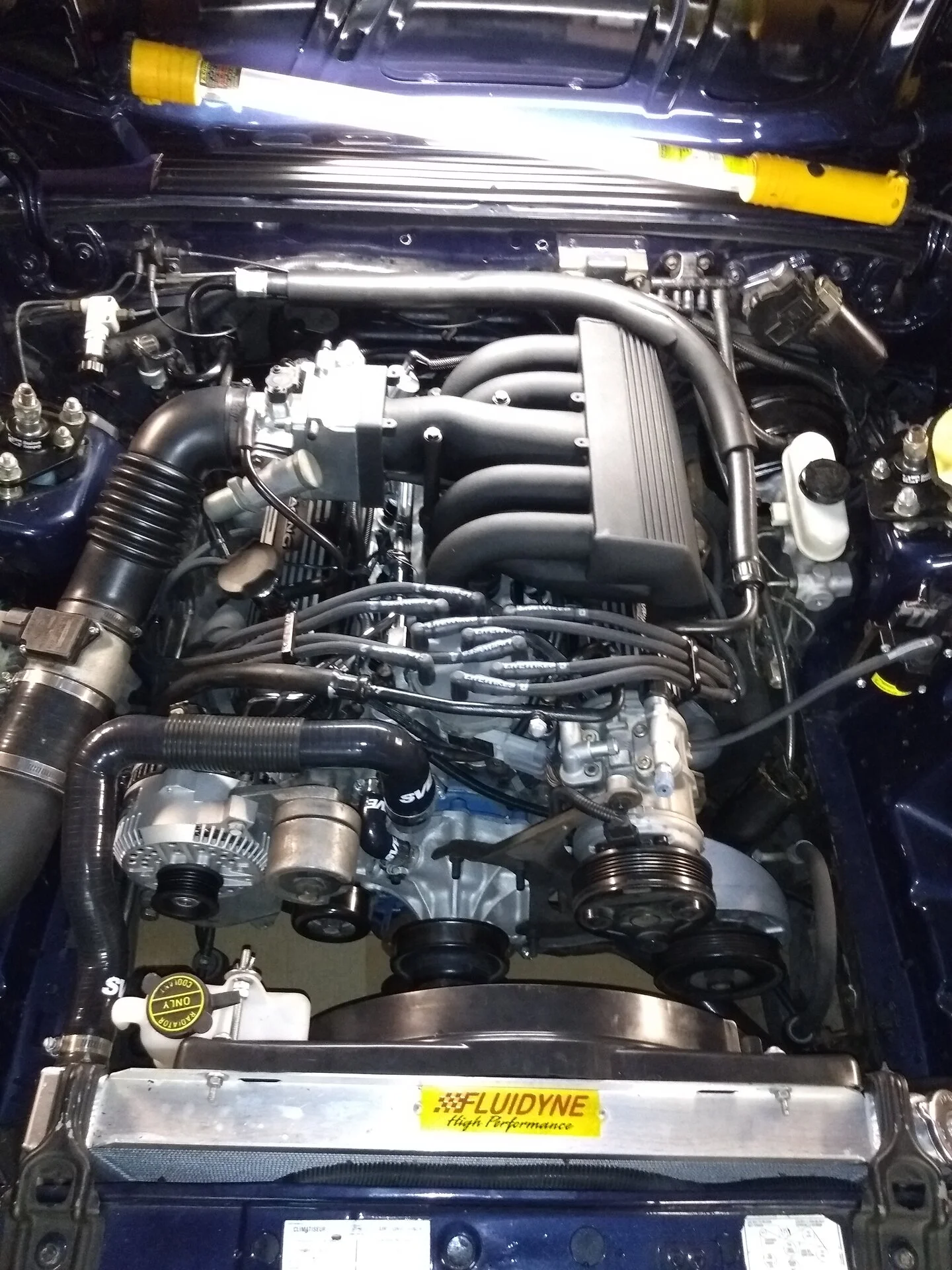

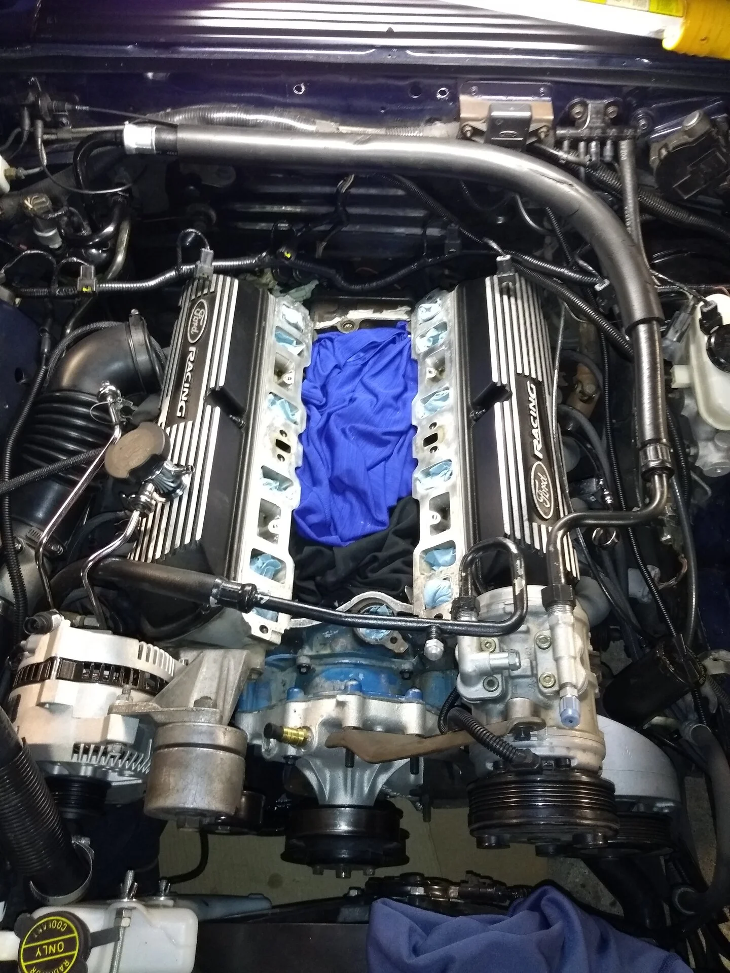

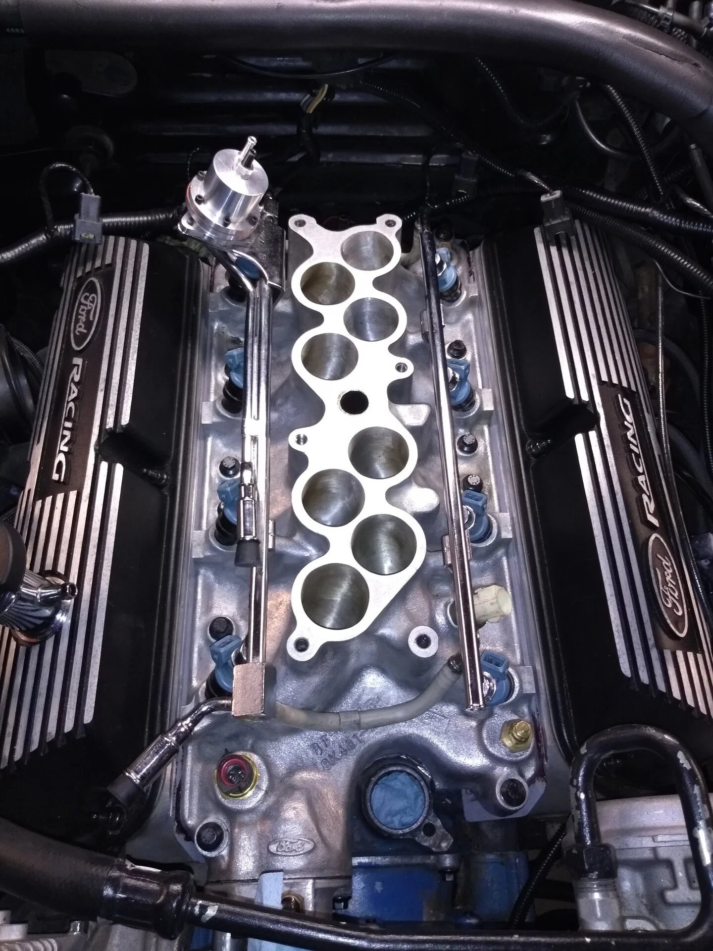

Update:
Hey guys,
I finished up the install yesterday and let it sit for about 20 hours before starting it. Filled the coolant, set the timing and let it run up to operating temp.
No leaks, so I let it cool down some and re torqued the lower intake bolts and changed the oil.
I haven't driven it yet, but had it running for quite some time in the garage.
I appreciate the help!
