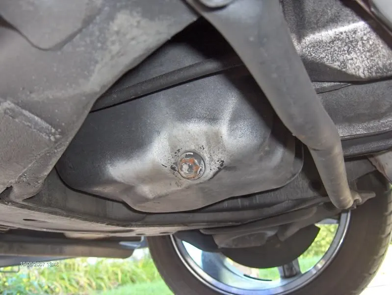

Hey guys I'm doing it and for some reason I can't find the drain plug lol, is it located on the driver side in front of the engine ?
It's on the bottom of the black metal pan on the bottom (center) of the engine. You should get a Haynes manual (from just about any auto parts store for about $15). It has a LOT of info, including pictures of the bottom of the engine (with the drain bolt shown and labeled).

The plug on the pan is on the drivers side about 1' behind the front axle IIRC.
Is this the bolt that needs to be removed for some reason I just cant find a matching bolt that I'm seeing on mustang world. :shrug:
