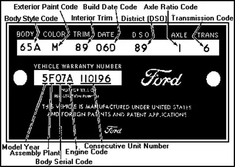

Assuming the following, No Axle Tag, no Door tag and thats its the stock 8 inch;
I come up with 3:00 for your numbers but I could be wrong.
Need more info.
If your set up is still stock, I agree with 2Blue2 - what is your axle code on door tag. Is your rear end open or posi?
Alternatively, try turning the drive shaft to get one wheel revolution.
The car was in a ten year on and off restoration that I recently finished. So I do not count on the door tag to still be accurate. There is no Axle tag so I have to assume that it has been worked, that is why I want to figure it out It is not Posi. I did the turning of the drive shaft (several times) and come up with 1.4 shaft turns to one full wheel turn.
Thanks I appreciate any help.
