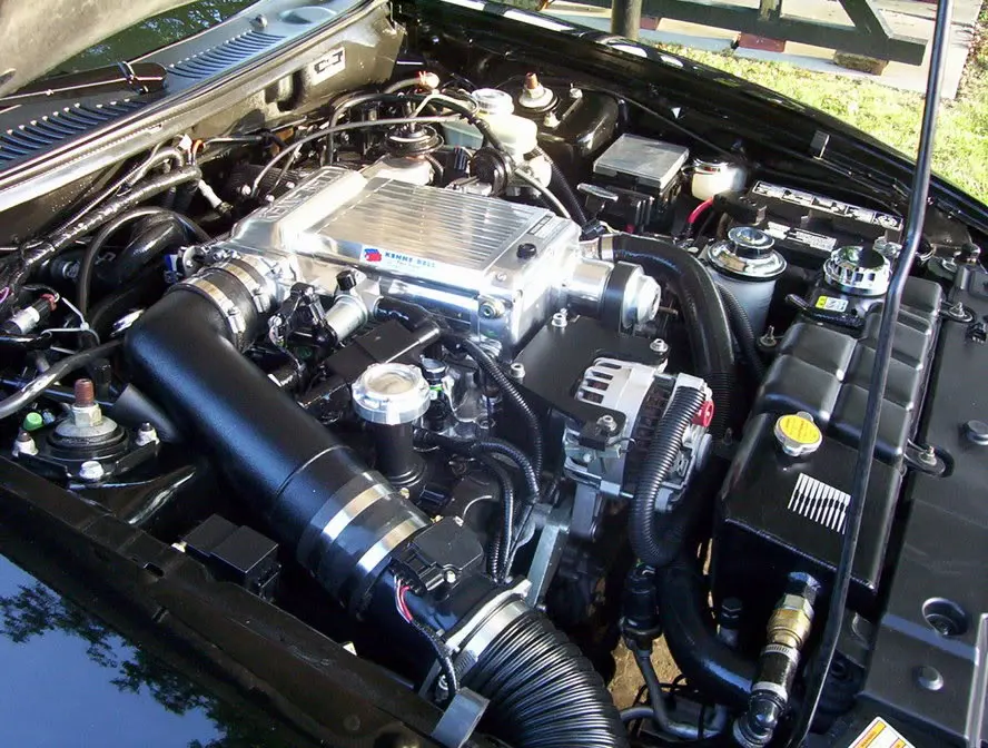

I'm curious with the KB bracket if a bigger alternator would mount on there. :shrug: I'd take a chrome stocker though. I just want the bling :nice:
I just added a UPR stainless steel radiator cover and polished hinged hood props too. Pics to come :D

I've got a chrome PowerMaster 200amp piece on a 1.7l KB set up
FYI....the bracket had to be custom-fabricated (holes wouldn't line up with the stocker).
Another reason online forums rule!!! Thanks for the pics and info.
Looks great! :nice:

2000blkgt where did you get the braided radiator hose? How much?
my guys at the shop fabbed it up
it's a proper #20 hose with fittings welded to the Tstat-waterneck, as well as the rad
but you need a new aluminum rad to make it work (can't weld to the plastic stocker)...the rad is a Fluidyne piece
I forget what the hose itself cost.....but the rad, fittings, hose etc etc...it was kind of expensive
